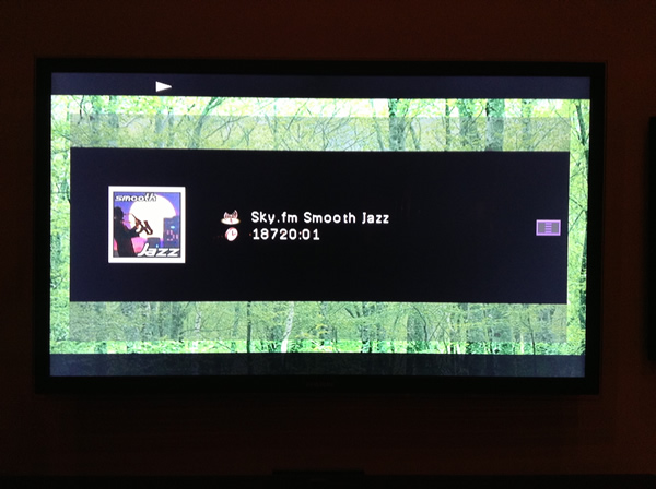

I like my Net Radio... Listening to SKY.fm Smooth Jazz for over 13 days straight!!!
Edited by VARTV - 2/24/13 at 4:19pm

Originally Posted by VARTV View Post
I like my Net Radio... Listening to SKY.fm Smooth Jazz for over 11 days straight!!!
