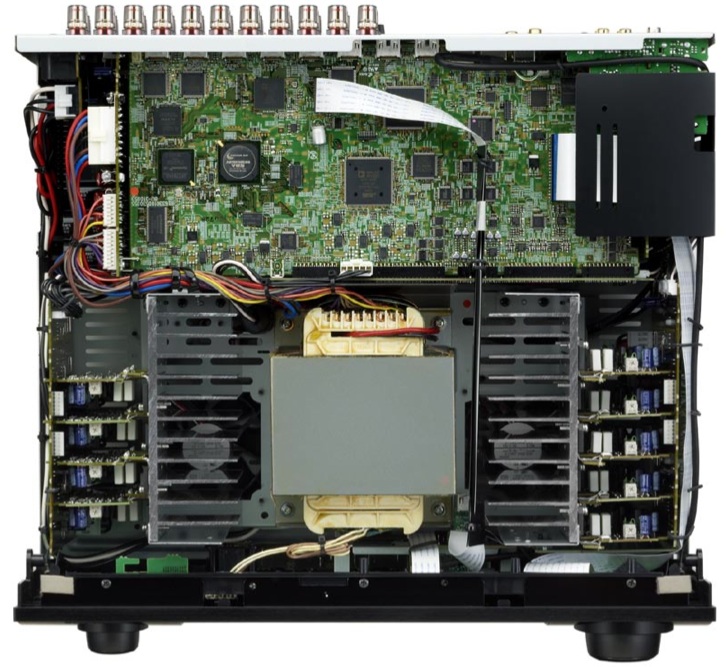

I've been searching for the "special edition block condenser" on the internal pic of the A100, comparing it to the internal pic of the 4311, and I've gotta say; I'm 99 % sure the A100 pic is a photoshop fake.
The A100:
The 4311:
First of all; Notice all cables and components being in the exact same position and angles on both pics. Second, notice the far right binding post on the 4311. See the black stud above it covering some of it when viewed from above? What about the far right binding post on the A100? Suddenly above the black stud? And third.. Does'nt the knobs and the front on the "A100" seem awfully matte to be glossy?
The rear end of the A100:
Considering this pic, it seems to me that the little black thingy is still above the binding posts, making it most likely that the A100 internal pic is just the 4311 pic with photoshoped binding posts. Agreed? Would someone with decent cameras PLEASE pop the hood on their A100 and 4311 and post REAL pics? I'm insanely curious of the "special edition" condenser/capacitor.
EDIT: I'm told removing the cover will woid your warranty, so I'd like to rephrase:
If anyone stumbles upon any real life internal pics of the A100, please post a link. No need in woiding warranty to satisfy my curiosity, none of you will and none of you should.

Yes, earlier in this thread someone showed how it is a modified picture of the 4311. It has not fixed the belief by some that the A100 is more than a rebadged 4311 with a history book, signed cert of quality inspection*, pretty faceplate and extra 2 years on the warranty.
*Clearly their inspection is nothing more than to see if it powers on considering they have the same issues as the 4311.
