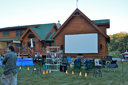

Why do you desire such a robust set-up?
The Home Depot plastic shelving I used works so well and seems to fit your criteria:
-2' deep 6' tall
-portable
-light
Pict fom 1 week ago movie set-up:
PJ is on 2nd top shelf, PS3 on mid shelf, heavy amp on 2nd bottom shelf.
