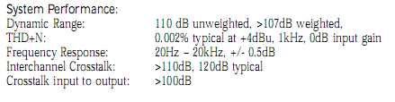

dbx PA specs
From DCX specs
Dynamic range: 109 vs 110dB: you've managed to do it Steve with a unit with the same basic specs, so it must be possible, something I've been saying, and doing, for ages.
And just to top it off here's someone else's set of measurements on a stock DCX, abeit using the SPDIF in (44.1k digital silence), so it shows the base noise of the processing and DAC and O/P stage.
[yellow curves]
and with a 1kHz -3dBFS 1kHz signal.
Note the vertical scale differences between the two images.
Analogue in won't be quite as good but the AD is a good unit (AK5393VS) and it's still a massive leap to go from this basic performance to a measured level of 60dB SPL.
From AK5393 datasheet.
My tests will be similar, but using the analogue in. Nothing else to get involved. I can get a stock DCX to loan, but maybe not till late in the week or next w/e. Going away this w/e.
When people continue to post technical rubbish, I will call them on it, no matter how much they scream and try to get me not too. Perhaps if said people did not post this, I wouldn't need to reply, no matter the title of the thread.
