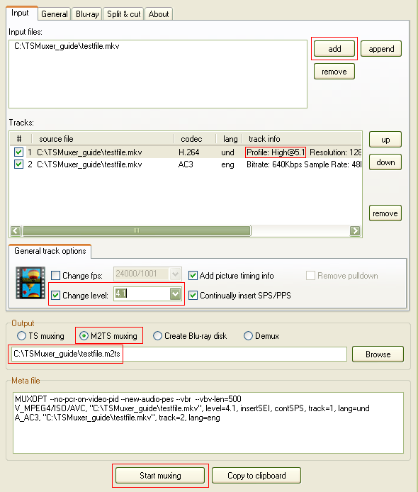

post #165 of 427

The option that worked for me (already tested on 3 different non-playable mkv's) as following:
Open your mkv file in tsMuxeR and make sure that your video track is set to level 4.1 or below (see screenshot).
Process usually takes less than 10 minutes Hope it helps
post #168 of 427
I actually forgot to mention that. I had to tell someone in the other LG thread that. I forget because I've still yet to come across a profile 5.1 MKV, but I have had to re-mux before with mkvmerge.
I downloaded the program and when I loaded the file in it, sure enough it said 5.1. If this works you are a lifesaver thank you so much!
Why did you do M2TS and not the others? (in other words what's the difference)
What do you do with the .m2ts file when you're done? do you make it into an mkv again somehow?

Ok the file now WILL play but it is very distorted/corrupted like all the colors get inverted and messed up

post #174 of 427
Output as m2ts was just one of the options. After testing and testing and messing around with different results I finally decided to use "Demux" option. That created 3 separate files: .264 file; .aac file and .sup file. Then mkvmerge did a fine job "sticking" all 3 files together and creating mkv. Try that and see if it works better...
post #175 of 427
Ok thanks
I tried with toy story 3 which was under 5gb and it worked but with files over 12gb it creates a file that plays fine on my computer but on my BD530 it has a LOT of color distortion. Bunch of green/yellow/pink squares it looks like a neon thing.
I will try demuxing it now
