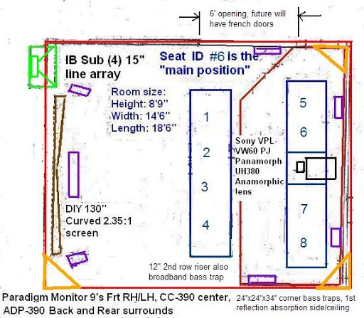

I've read all 7 pages of this thread and decided to give WOW a try, just ordered via Amazon and should have within 5-7 days (free shipping).
Also, I am hosting a Area Home Theatre Meet at my home in 2 1/2 weeks, Sat May 14th, http://www.avsforum.com/avs-vb/showthread.php?t=1322007 .
Calibratrion was not on the agenda, but since I'm getting this disc, and already own DVE, I can see value in a brief review of the 2 discs for the 12-14 avs members who will be over.
This gives me the weekend of May 7th to use this disc, so I'll probably post here my impressions and whatever q's arise.
fwiw, here is my HT layout and equipment.
I'm decent at using REW5 also.
