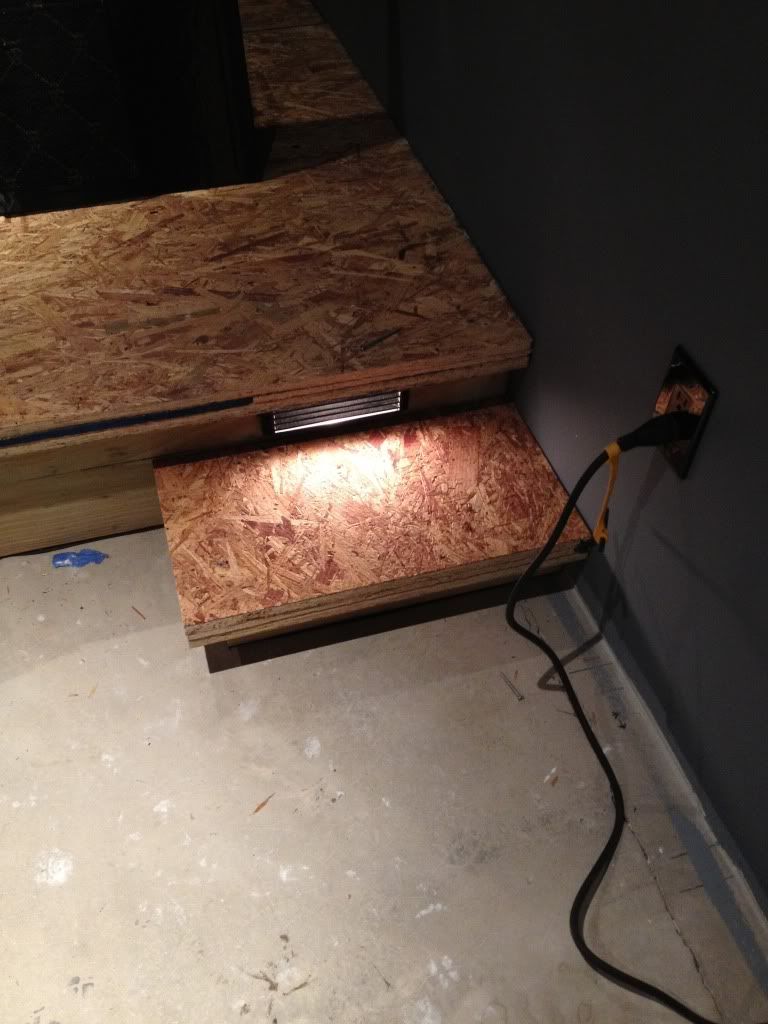

Last night I finished the step in the equipment room. (Am I EVER going to be done with Green Glue?!?!) I also checked out the trim options at Lowe's and wasn't particularly impressed. Tonight I will build the two riser steps in the theater.

I have been moving along on my pre-carpet punch list over the past week...
Carpet should be installed around the end of next week. I also finished the riser steps and equipment room step. There is one layer of ply left to add in the equipment room and then I need to cut the vent holes in the riser.
