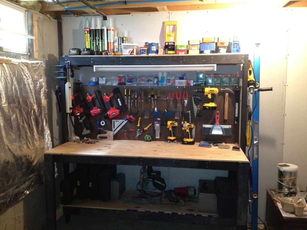

Then I started cleaning. I had very few tools when I started this project. I'm sure my inventory is still really meager compared to most everyone else here, but I needed a place to store some stuff other than the basement floor and an old coffee table. So I found my favorite type of plans on familyhandyman.com (aka the free kind of plans), gathered my leftover materials, and built my first ever workbench. I had enough 2x4 scraps to make the entire frame. Here's what I had to buy:
Plywood top: $15
Fluorescent Shop Light: $20
Bulbs for Light: $8
Handy Dandy Pegboard Organizer Kit: $11
Materials total: $54

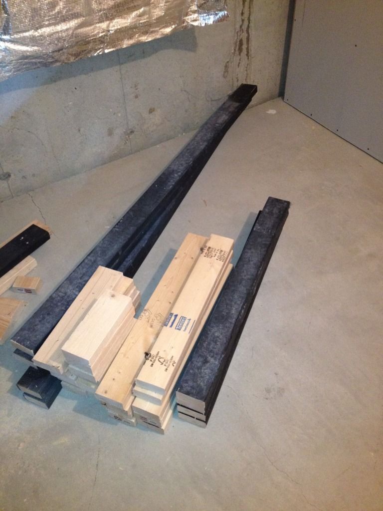

So I cut a bunch of sticks to size (some of them are black from being used in the screen wall in my temp theater):
Put the frame together, added plywood, pegboard and tools, and voila! Workbench and tool storage:

Work bench looks awesome. I'll help you lift those bad boys. I was lifting the CNC for practice today.
post #1566 of 1739
Really nice job Benji!
post #1567 of 1739
Love the workbench Ben! Fantastic job.
