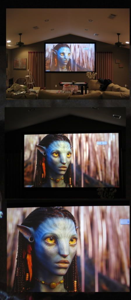

Screen shots? Progress? Good question!
Seems everything came to a screeching halt near the end of June. While we have used it to watch a lot of movies since then, I have had little to no time to do ANYTHING since. And it's not because I turned the PJ on, like has happened to many others. Life has just taken over everywhere else with work, kids, etc.
MMan wanted some shots for an expo he was doing, so I quickly and roughtly Photoshop-ed a couple together. I haven't even calibrated the PJ yet! At least it's something to show. On the "Full Lights" shots, I have every light on in the room, including two cans that flood the screen wall. I'd say the screen wall does pretty darn good considering all that light going onto it.
As you see, one of the biggest tasks is the screen wall, including the 4-way masking system. Sure hope all those motors and parts I ordered months ago work! Other than that, the whole remote control system has to be done and I've been working on it here and there (iRule). To do it right takes a lot of time!

post #342 of 351
RTD......,
Are those Floods or Spots in those Cans? Spots would make a huge difference if what we are seeing are in fact Floods.
BTW, your dead on about the screen's performance under what is an obscene amount of directed light. Considering the sheer size of the image, and the throw distance involved, even I'm impressed that the image remains as "resolved" as it does. One can only speculate at present what the appearance would be if the "Above the Screen" Can Lights were left off while the others remained at Full Illumination.
Another good addition to the Forward Cans besides changing over to spots would be to install "Eyelid" Shields, with the opening toward the seating. For that matter, those type Can Shields (...also referred to as "Wall Wash Lenses...) would cast a directed illumination against the Walls, that while still providing both accented highlighting to the decor and more than sufficient room illumination for a "Theater" environment, would greatly reduce the amount of detrimental ambient light in the room.

They are flood lights, pretty sure. I have them on a different GE zone, but I don't have my remote control system all set up and the GE panels are behind the A/V racks. Therefore it was too much with the time given to turn just those off. I have thought about using different bulbs and using the shields/wash lenses.

How do you cut and paste the pictures for screen shots with the lights on?
Like what program and function etc... My wife has our pics and cant figure it out.
post #346 of 351
I did it in Photoshop, cutting out sections from the dark shot (i.e. screen and star field) and then "layered" them onto the lights on photo.
post #347 of 351
