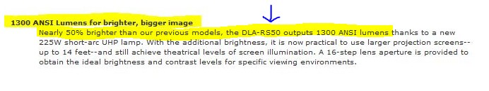

Jon, on #4.. I'm a little jealous considering how much my lamp dropped off after the first 100 hours. I am hesitant to use my replacement lamp because if I sell it, it will be a great incentive to include a brand new lamp. Curiosity is starting to get to me and may fold soon.
Your first point is really what I want to know. Art has asked this of JVC with his supposed 'defective projector' as some members have referred to it as.. but it's performance is nearly identical to everyone else.
Let recap once again, so if any JVC employees are reading (or potential customers), it will be clear as day what some of us are up in arms about.
1. Why do the lumens drop anywhere from 40-50% when any of the usable color profiles are engaged? Previous years were typically 15%.
2. JVC advertised 50% brighter than previous models. Which models are these? the RS50 @ D65 is on par with the dimmest model RS2 from 2008 with an advertised lumen output of 600.
3. Why is the RS40 putting out 30-40% more light in their usable modes vs. the RS50/RS60? They use the same exact lamp.. so what is wrong with the 50/60?
And as well (or at the very least if they defend these published specs for ANSI Lumens), by what set-up parameters were they able to attain the 1,300 mark (screen size, throw distance, user settings etc...)

Regarding the lumen issue. Here is what I thought I knew...
  1. The RS50/60 lumen output drops significantly when a color profile is engaged.
  2. The RS50/60 lumen output is lower than the RS40 lumen output.
  3. The RS50/60 lumen output is lower than last years models.
With the recent posts correcting me it now appears that 2 & 3 are sometimes true and sometimes not: OTOH we have Mark_H, Zombie, Gotcha, Krichter, and others, and on the other hand we have Manni, Jonathan, and Kris's experience.
I think 1 is mostly due to the wide spectrum of the bulb....the light produced by the bulb that is not within Rec709 is simply not projected. Since this years bulb has a wider spectrum than last years model it stands to reason that more of the bulbs raw light output is being wasted because it's outside of the projected color space (when a profile is engaged). The end result is a larger lumen drop between no profile and any color profile. What makes the 40 & 50 different is a question Jonathan first posed and it would be nice to hear an answer.
Item 2 seems to be true for most folks. I'm still confused about Kris's experiences but actual Lumen measurements and projector settings would have helped.
Item 3 is false for some (Manni and Jonathan) and true for others (Mark_H, Zombie, etc). As Manni mentioned to me in a PM this might be attributable to the zoom lens. Light loss thru the lens is minimun at the shortest throw and Manni and Jonathan have short throws. Perhaps this years lens has more light loss than last years (over all or part of the range).
With only 5 votes from dissatisfied 50/60 owners it's apparent that most owners are satisfied with their units.
