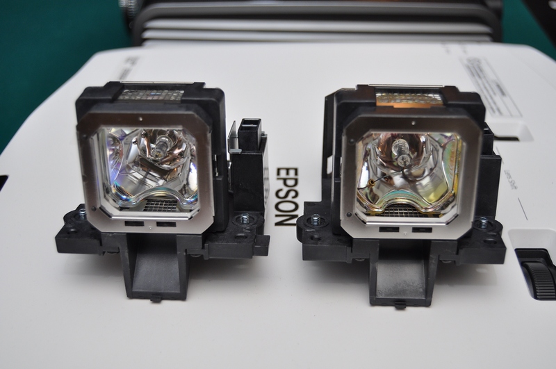

the issue with the lamps was likely related to air-flow. I've compared the old lamps and the new style (46/56, etc). There are obvious size differences in the output of the fan that is providing air. I have since verified that the RS46 fan is definitely larger than the 40/50/45/55, etc.
I did an experiment with my Rev 2 lamp (non-flapper) and ran the system on "high Altitude' since it was new. This lamp has been performing very well so far. The increased airflow is likely helping here. Perhaps the metal flap was introduced to break up turbulence in the air-stream.
I don't recall anyone complaining about a Rev 3 lamp with early dimming. The irony of running the RS55 in high altitude mode is that it's still a bit quieter than the current RS46/RS4810. In high lamp, those new style fans are getting a workout.

This is very interesting. Could be that the airflow is insufficient due to the smaller outlet or could be that the smaller outlet would direct air at a higher velocity. Can't tell without being able to run the PJ without the lamp...which you can't. But very good info! Thanks for taking the pictures.
post #9595 of 9660

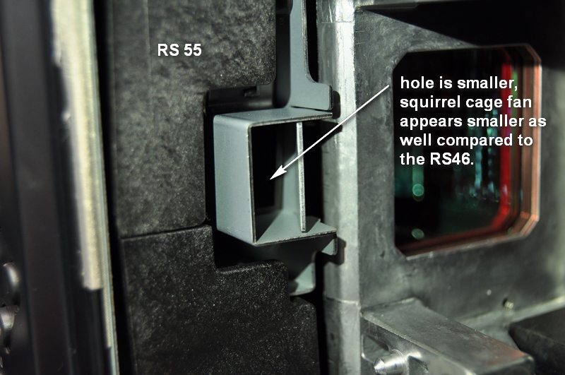

The inlet on the new lamp housing is identical. The new lamp does not have the metal flap as seen on the Rev 3 lamp for the older models.
based on my positive experience running in HA mode and the larger fan + outlet opening on the new models, I believe much of the issue had to do with airflow.
The new models are surprisingly loud in 'High Lamp' mode, more so than the older RS55 with HA / High Lamp. I'm sure this is helping in addition to any lamp revisions.
** Notice the metal 'mesh' opening is larger on the new lamps (new lamp is on the right) which is letting in more air.
