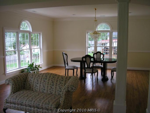

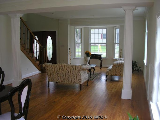

Speaker Placement: Speakers on opposite walls facing each other is usually a bad idea as they can cancel many frequencies out. It is important to have uniform sound but it is possible to have too many speakers. If the house is traditional construction ceiling speakers do an excellent job of covering large areas without hotspotting. Also do not worry about moisture in any rooms. Modern materials hold up very well to moisture.
Front of Room
Rear of Room
The speakers for the front (either side of the bay window) and back (again either side of the window) will be about 30 odd feet apart from each other. I had read that wall mounted speakers sound better plus the ceiling already has a lot of can lights (8 can lights, 1 chandlier 3-4 HVAC ducts) and I thought it would look bad to add 4-6 more speakers on there. I was debating putting two downfiring speakers in the middle to make the sound a little more uniform

The speakers for the front (either side of the bay window) and back (again either side of the window) will be about 30 odd feet apart from each other. I had read that wall mounted speakers sound better...
All depends on the speaker brand/model. Ceiling speakers have had a reputation of being cheap and lousy-sounding. But that doesn't have to be the case. Lots of very good quality speakers out there. I would personally recommend Boston Acoustics line, great sounding at a moderate price. Many folks here have also had good luck with the ultra-cheap Monoprice speakers. If you stick with a popular speaker/cutout size (6.5"), you can always go cheap, and upgrade to a better/larger speaker later if you choose. Just don't get a super-big and super-cheap one, as it may limit your future options ('cause a big hole is hard to fill!).
...plus the ceiling already has a lot of can lights (8 can lights, 1 chandlier 3-4 HVAC ducts) and I thought it would look bad to add 4-6 more speakers on there. I was debating putting two downfiring speakers in the middle to make the sound a little more uniform
I'd actually say it's exactly the opposite. With all that stuff on the ceiling, no one is going to notice a few more circles... Whereas, on the wall, they are directly in the eye line, and you eat up wallspace that may have been used for anything else (art, decorations, window treatments, etc.). No one looks at your ceiling, but they will immediately notice the big things in the walls (even if they're painted to "blend in"). Putting them in the walls (since these are all exterior walls, too) will require many more cuts/repairs in the drywall, too. Something else to consider.
I think 2 pairs, mounted in the ceiling along the long axis in each of those two rooms will be fine. Especially with the hardwood floors (nice room!).
