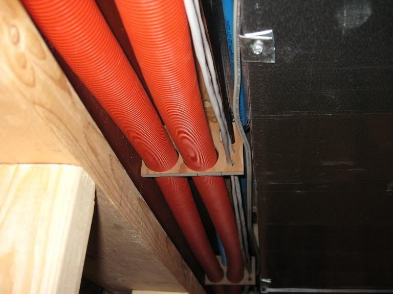

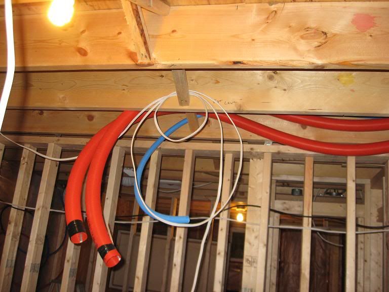

I have all of the low voltage wiring in, as well as conduit. I ran two 2” conduits from my AV closet to where the projector will be, as well as two ¾” conduits from my AV closet to the front of the theater, and one ¾” conduit from the projector to the front of the theater. I think this should be enough. All of my speaker wires, coax for the subs, and cat5e have been wired.

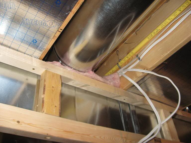

Onto the HVAC. Started to install my 8” supply, which will bring air in from the basement, along the ceiling, down into the soffit with flexible duct. As you can see, I made a 9x13.5 box from which I attached my duct.
The one issue I am having is with the duct in the ceiling joists. It is going to be tight, since I also want a 3” pot light there as well. With the wiring, the duct and gas line, not sure if this is viable or not, especially with my pot light so close to the gas line. I guess I may need to go with LED in-contact lights, and just wrap with insulation.

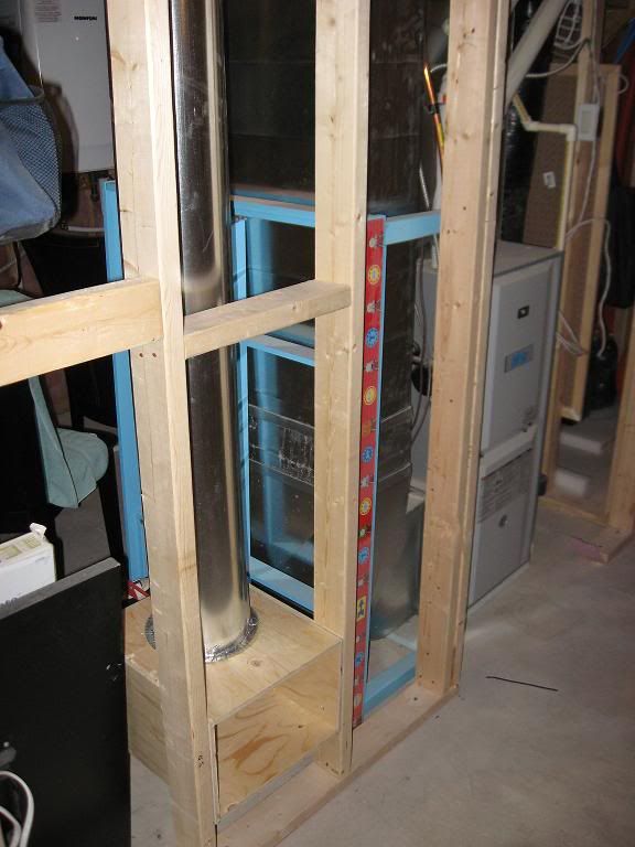

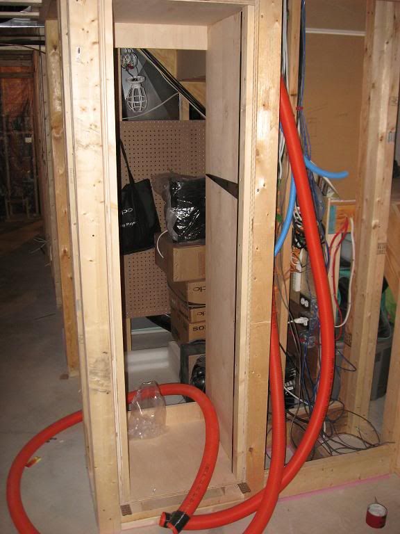

Well, I need some help and advice. I am now second guessing my HVAC!
First the supply. I originally wanted to have an 8" supply pull air in from accross the hall near floor, up the wall, through the joist to the soffit and about a 10' run before exiting ino the theater. This is all based on sound proofing HVAC that Soundproofing Company suggests. I am OK with this, although it was tough getting the duct in the joist cavity, while insulating to avoid some wires located in the same space. The issue is the length of the run. In total, I am looking at around 45. Is this too much?
Second. I have 6'6"x2'10"x2'6" of closet space dedicated for a dead vent. The problem is that the DV is right under the house return trunc, and the duct into the room is right under that (it will be DD/GG for sound, and will be a soffit), with no room to move. I don't mind keeping the return there, but a 10" or 12" opening for the return seems pretty extreme. Am I over doing this? Also, do I need to put a grill or linear diffuser or can I just pull air through a fabric wall (I plan on fabric walls).
Third, I was hoping to tie my projector box ventalation to my return dead vent. I will not be able to accomplish this as it is right now, and the best I can do right now is pull the air from the box and deposit close to where the return is.
I need some input to make sure I am doing the right thing. Is it possible to have 2 separate chambers for a dead vent, one for the supply and one for the return in my space that I have (6'6"x2'10"x2'6")? My thought was that I could build a false wall at the rear of the theater, run my supply from the DV to the other side of the theater (behind the wall) and then up the wall and down the soffit, saving maybe 10'. Also, I could then bring my project box vent and tie into my return. If I do this, then I obviously loose about a foot of riser space, shrinking from around 8'6" to 7'6" before DW etc.
I hope that makes sense. You can see the return and where my DV will be placed. I have changed a little since then (this is an older pic), and my DV will now be outside the room in the same space.
