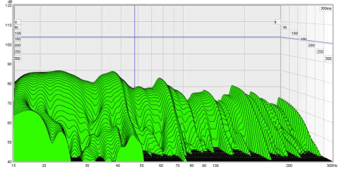

For a long time I believed that bass traps were the ideal for the bass perfectionist, if you had the space for it or if your room is a doozy. As my room was small and quite good for bass, I wasn't sure I really needed them. My argument went like this: "My room is one big bass trap, how much will a few corner traps add? They will take up too much space and probably not make much of a difference."
Then I realised I had all the bits to throw them together. It took all of 15 minutes to put up some mattresses and couch cushions in the corners with louvre doors in front to avoid making the room dead.
The result? Wow. The best bass I've heard in my room by far. It sounds a lot more like outdoors bass, yet with the increased output and extension you get from a room.
I took a lot of measurements and did it step by step. Opening door/windows, progressively adding treatment. At this point I could measure but not hear a difference. Then I rigged up the 3 big traps and it was a big step up. This measurement captures it best:
Turns out the time domain does make a difference for bass. I say this because it's not hard to get the bass flat. I've done that before.
So I'm sharing this to inspire people to try it. My suspicion is that if everyone knew how good these things are, there would be two new groups among audio enthusiasts - those who have bass traps and those who wish they did!
Instructions here:
Take the free bass trap test!
And here is my result when I tried it:
My free bass trap test

I don't know the context of Bill's statement so it may be unfair to him to challenge it here in a thread he is probably not following. But I'll respond to the idea that bass traps don't work below 80 Hz.
You can see from the waterfall that I posted that clearly there is a difference below 80 Hz. In fact you can see an improvement down to about 20 Hz. I would not have been surprised had the traps only worked down to 100 Hz, I was intending to target 100 - 300 Hz and do the rest below that with EQ. I figured EQ can work below there well enough but above it would just require too many filters and not work well.
BTW, one comment about reading waterfalls.
I've shown it here. See how the modes ring out? I've highlighted on in particular. It's a good one to illustrate because there is only a slight peak, and yet in time it rings out much longer. If you were to EQ down the peak, the mode would still ring out in the same way because it's an acoustic issue can can only be fixed acoustically.
It's a visual trick, but you can be fooled into thinking that EQ fixes the time domain. EQ out a peak and it passes through the Z axis floor quicker, but in reality the decay rate has not changed. After EQ the bass decays at the same rate.
But if you look at the waterfall after the bass trap, the rate of decay is much faster. The decay is more even, because there is much less difference with the modal decay. This is the biggest tell tale sign of a measurement of a trapped vs untrapped room.
No doubt there are plenty of traps you can buy that are simply too small or not the best material.
If you are in doubt about if bass traps do work, then all you need to do is repeat the test I tried. You don't even need to measure or build anything. Just throw it together. Then come back and share what you find. I think for most that quick test will seal the deal.

Just took a waterfall now, and not sure I'm doing things right, but anyway...
'Super chunk' in the front corners (roxul triangles, stacked) plus one about mid wall where there is a corner.
soffit - full perimeter (6" x 24") roxul, fabric covered
Dedicated room, lots of additional treatment, probably too much.
Not sure what the 60hz noise is....
Also, it is me, or is the alternating graph in the OP alternating between 300 and 400ms exaggerating the effect of the traps?

Ooops ... the different time scale is a mistake. At the time when I did those, I wasn't thinking about posting the results and I'm not sure why I changed the scale. Here's the corrected version.
