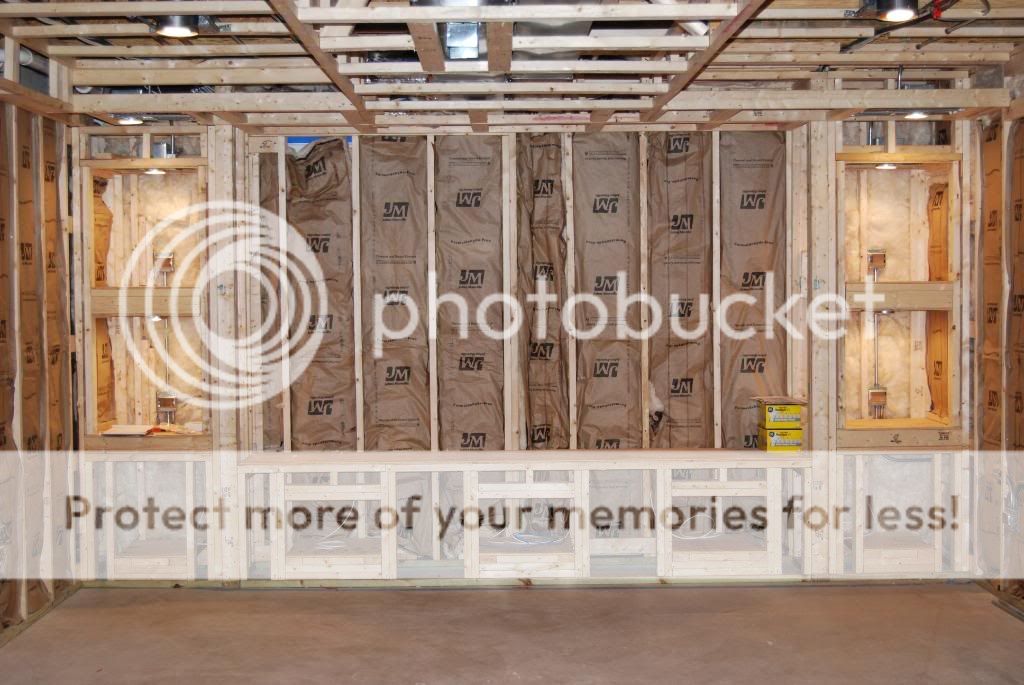

Working on finishing the light rough-in phase for theater room. All ceiling cans are in and most soffit cans and sconce boxes also installed. Just a few left before wiring phase begins. Also taped up the new and final screen dimensions.
Crazy amount of lights: Better to have too much than not enough right? These lights will be split in half into two zones
The soffit 4" cans. These alternate with sconces every 4 feet
A view of the room as it is now after cleaning up and decluttering a bit
