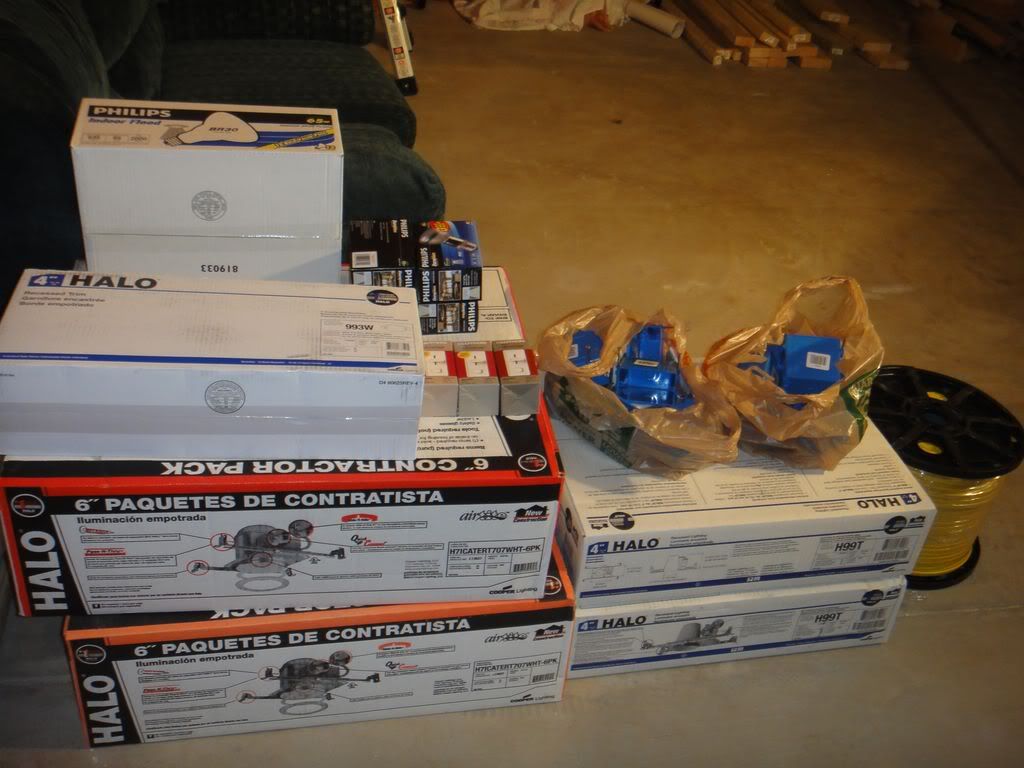

Next step is going to be lighting in the gym. I want to get a feel for how much light the can lights will produce so I can get the theater/game room area right the first time. If the gym isn't perfect that's ok, I will take it as
Next up on the shopping list is several contractor's packs of can lights and a 1000 foot roll of 12-2 wire.
My big lesson learned on cans is buy halo. i bought 4" halo's and 6" consumer electric (Home Depot brand). Amazing how much better the HALOs are!

This is great advice! I was looking at some Consumer Electric housings and they seemed flimsy compared to the Halo housings. The Halo cans also seem much more user friendly to work with in just about every way.
post #71 of 200
If the 6" consumer elecrtrics weren't nailed up, i'd return them. The Halo, at least on the 4" cans, had a nice built in clip for romex so you don't have to goof around with the metal conduit need to screw romex holder things (that's a formal term). And, the halos nail up so much better.

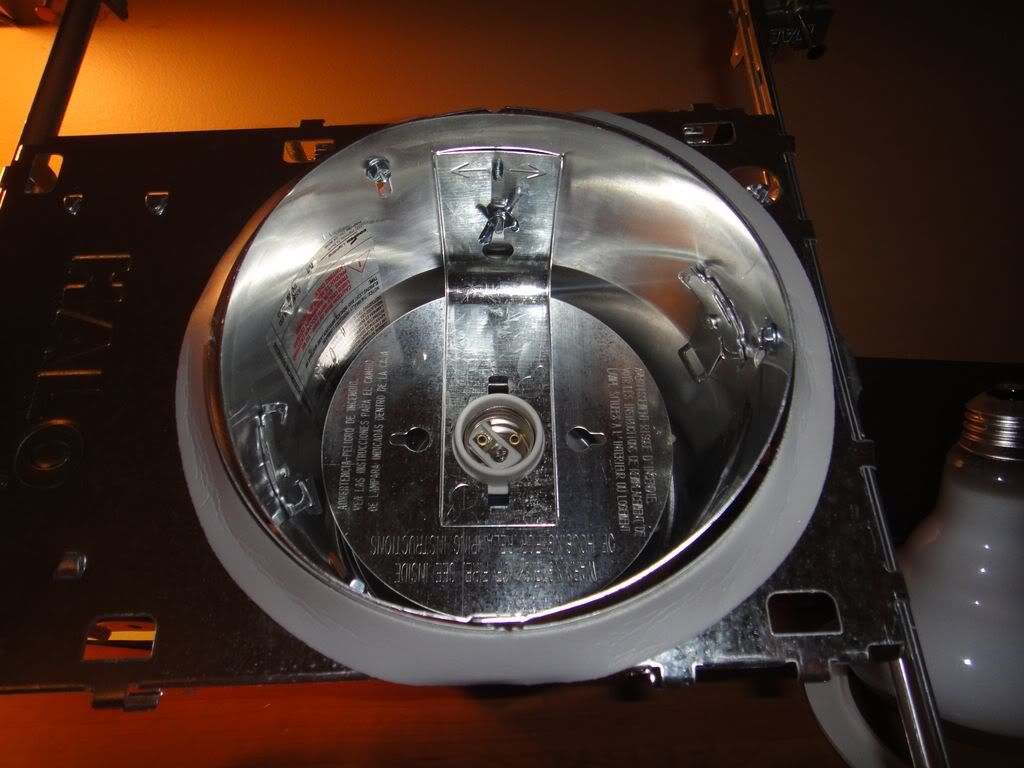

Has any one used the 6" IC rated Halo contractor's pack that includes trim? If so, can you let me know if this looks right and answer some questions?
1. Here is the empty housing. Loosening the wing nut allows me to adjust the depth of the socket but I can only bring it closer to the surface and not deeper into the can which I would prefer. Is the screw at the top of the channel (in between the left and right arrows) there to prevent the socket from going any deeper into the can? There is room to go deeper if I move the track down past the screw but I'm not sure if that is ok to do? I was thinking that maybe with the IC cans that this is as deep as the socket should go?

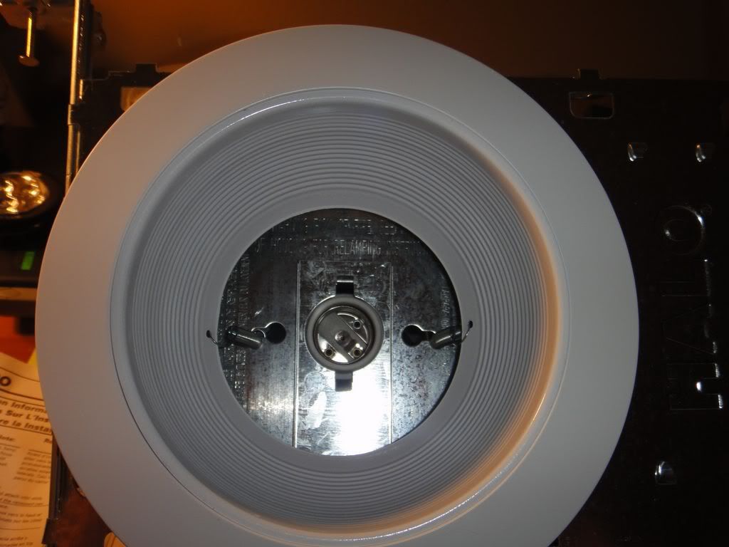

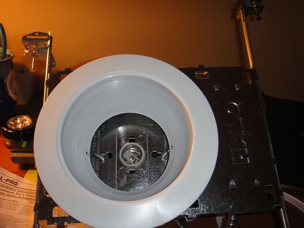

2. Does this look like the correct installation of the trim/baffle? The instructions weren't very clear or detailed with the trims/housings but I can't see how else these would fit. The trim fits kind of loosely but tight enough to stay in place. They seem kind of cheap but I got 6 for $70 so I guess I'm not expecting much:

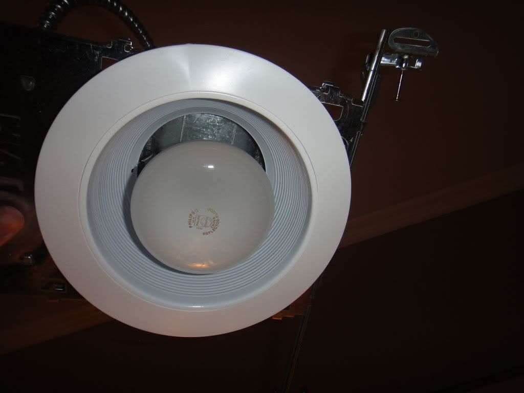

This is how it looks with a 65W bulb in it. If this is the best I can do with a 65W bulb then these are going back because I can't stand it. The bulb comes down past the trim. I would prefer the bulb to be more recessed into the can but maybe this is the best I can do unless it's ok to move the socket down deeper into the can. Or, maybe there is a shorter 65W bulb out there that will not extrude as far?

I have the same lights and trim and you should be able to set a bulb in there without having it stick out past the trim.

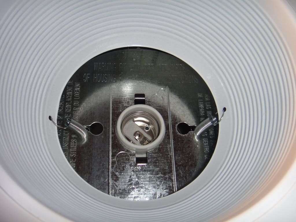

What bulbs are you using? Maybe that is where my issue is. Also, if I move down the socket bracket past that screw on top, and make the top of the bracket where the screw with the wing nut is, it's perfect. The trim is nice and tight and the bulb is inside the trim where I want it. I'm just not sure if it's ok to do that?
This is what it looks like if I do that:

I'm also starting to wonder if I used these...they make a model like yours but without the socket plate. I'll look tonight and let you know for sure...
http://www.amazon.com/Halo-H7ICTNB-6...74-blogspot-20
post #78 of 200
I wonder where the springs would clip to with ones like that? There usually aren't any side clips for the IC housings. I think that is the exact same housing I have minus the socket plate. I checked the rest of my housings and they all are on the top screw. I still can't imagine that it's wrong to move it down past the top screw. There is still ample space underneath the socket plate even when I have it as far in as it goes.

You have the wrong bulb for that can/trim.
I believe what you need is an R20 or PAR20. That bulb looks to be a BR30.
With the correct bulb you should not have to adjust the depth of the bulb beyond the screw.
Check the label on the inside of the housing. It will say which bulb to use with the trim you have there. Different trims use different bulbs.

Just checked my lights and they are all in the configuration you show in the later pics, the one where your bulbs fit. Mine came out of the box in this way as I mentioned I only had to adjust one can housing. My bulbs are a mix of Fleet brand and GE brand. All 65 watts and the GE show R30 for a size. Can't see a size on the fleet brand. I think you are fine to raise the socket plate. Why would the screw be there if you couldn't...right?

Thanks Mr. Tim, the housing says it's ok to use BR30 bulbs for this trim so that's why I thought I should be able to use them and adjust the socket bracket to be deeper into the can. If I don't move the socket deeper into the can the trim is very flimsy and loose and the bulb extends past the lip so it almost seems like I am supposed to move it in. Also, thanks for the smoke alarm tip! I am going to replace that with a CO/Smoke alarm unit. When I added that block I was wondering if there was some kind of minimum distance I should have it so know I now. I will be relocating it at some point.

Thanks for checking chpwaman. I'm glad to know you're using this configuration without problems. I looked at the rest of my housings and they all are defaulted the same way. I have looked everywhere and read as much documentation as I could find on these lights/trims and nowhere does it mention this top screw or state not to adjust the socket bracket deeper in the can. I have a question into halo but not sure if I will receive a response or not. I am going to see how a PAR20 75W looks with it at the default height. If I like it I will go with it otherwise I'm sticking with the 65W and raising socket plate.

Here is the installation sheet for the 993 trim. The spings are inserted up onto the keyhole slot (never saw that before).
Here is the installation instructions for the H7ICAT recessed light
From the installation instructions, "NOTE: Some housings allow only limited vertical adjustment of the socket plate. Do not attempt to defeat these safeguards." I would not try to adjust the bulb beyond what that screw will allow.

Thanks for looking that up Mr. Tim. That is the first time I've seen that mentioned about the limited vertical adjustment which is what that top screw appears to be. It doesn't mention this in the instructions that came in the box but I'm glad to see it written somewhere. This is good information. It's still strange that the trim doesn't fit well when it's limited to this top screw. I did find if I flipped the spring so the longer part is below the key hole in the socket plate I can get a tight fight with the trim when the socket plate isn't adjusted beyond that screw. So I will most likely keep it there and either go with a shorter bulb or live with the BR30 extending past the trim a bit. These lights are for the gym area so I'm not too concerned with either choice but when it comes time for the theater lighting I may go with different housings/trims because a recessed bulb is a must for me in that area.
