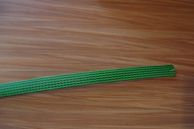

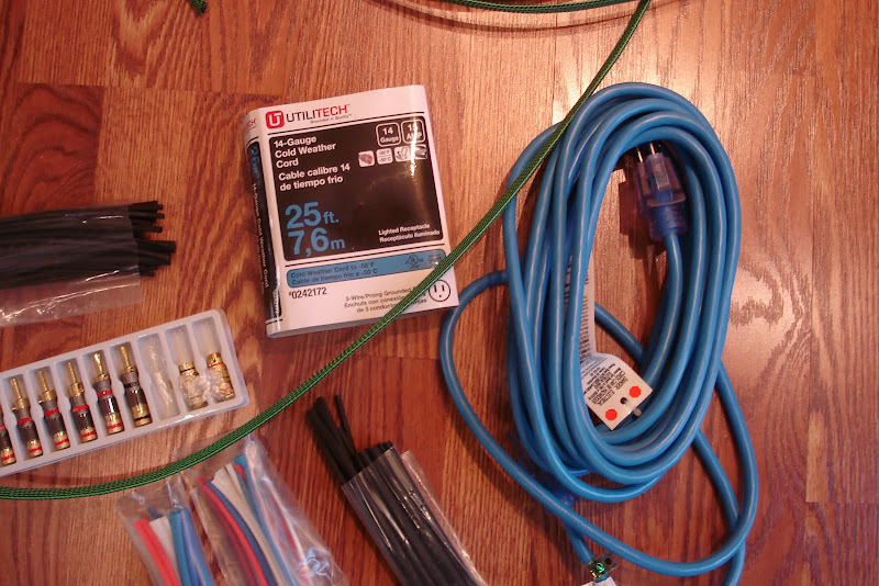

All right , you asked for the pics so here goes:
I got a couple of cords for Christmas from one of my brothers and I truly have too many already so I thought it would save me an order with BJC or MONO, the tech flex came from E Bay last summer, heat shrink from parts express.

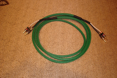

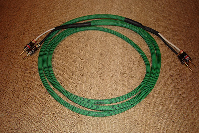

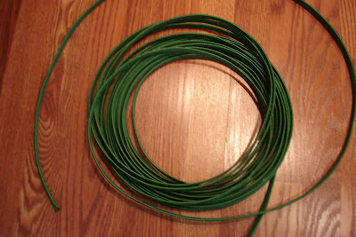

The tech flex , it looks like the same from another in this thread.
Not too shabby I tried the cable pants from parts express and actually thought they looked out of place so I just made a skirt out of 1/2" shrink in black.
post #119 of 2777
heres up close with the GLS locking which I am not really crazy about but they will do for now:
Now these cords have three wires inside black white and green so I made these like this, white is positive at both ends, at the AVR the black only is used at the neg terminal, at the speaker side I have both the black and green twisted and hooked to neg. ( back at the avr side the green ground is nipped flush with the tech flex and buried in the shrink). I read an article about this set up on another site about how this would be beneficial and improve something in the speaker performance and so on and so on , I wish I could link but I lost the bookmark a long time ago but always remembered so I gave it a shot, to be honest I don't hear the difference but I dont have my conk shell insulators in place yet.
These are the first pair of cables I tried so hopefully I will get the knack and pass quality control. I know, yes I will make more , why not, lol.
