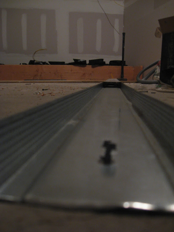

It's difficult to do without a string or some sort of a compass. I used about 12 feet of steel track and pinned one end to the floor. Then I drilled a hole in the other end and put a pencil in it:
If you can't do that, give me a width and depth at the deepest point. I'll plot it in autocad and give you measurements ever 16".
