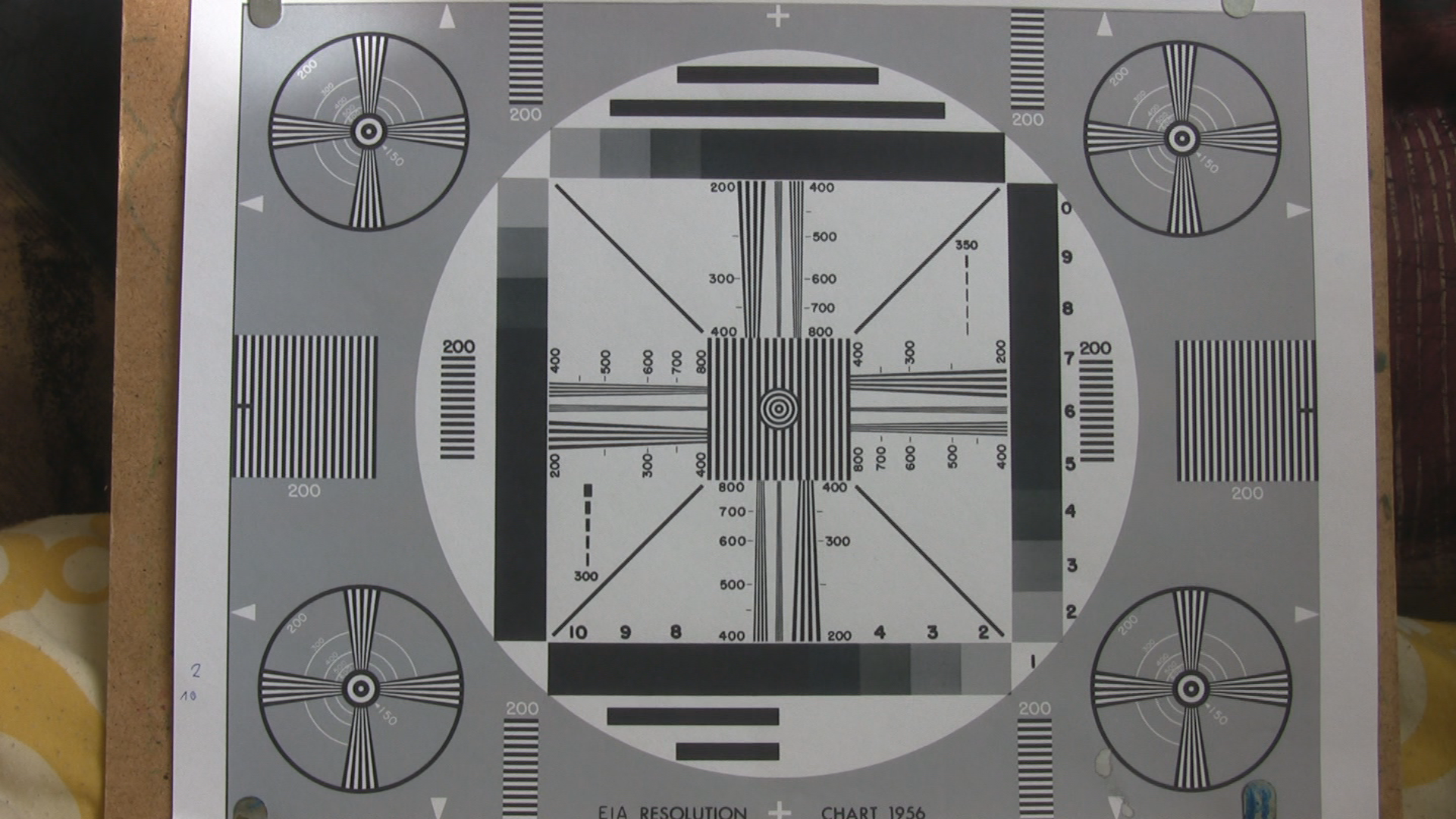

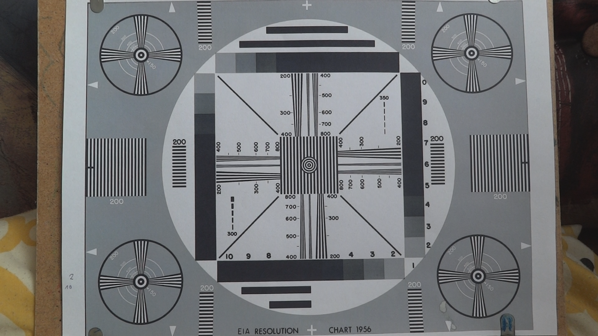

Today i printed a resolution chart and played with my cams.
What was interesting that TD10 in 2D mode is a lot-lot sharper than in 3D mode! I think it's because the full sensor area is not used because of parallax adjusting possibilities, but i wondered how blurry is the picture in 3D mode In fact even my many years old Canon HV10 with 1440x1080i resolution was way sharper!
I also have a HX7V full hd camera, and grabbed some frames in progressive format. I get the same resolution like with TD10 in 2D mode.

Here is the test grabbed progressive frames.
First, compare TD10 in 2D and 3D (with stabilizer off):
http://www.relaxvideo.hu/res-td10-2d.png
http://www.relaxvideo.hu/res-td10-3d.png
I think anybody can see the difference. It's not small.

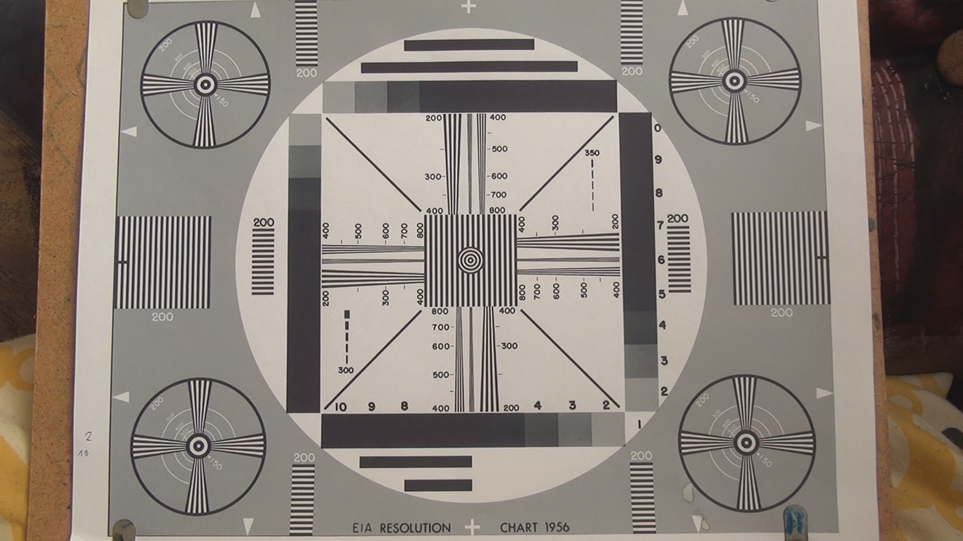

Here is the nice, light hx7v:
http://www.relaxvideo.hu/res-hx7v.png

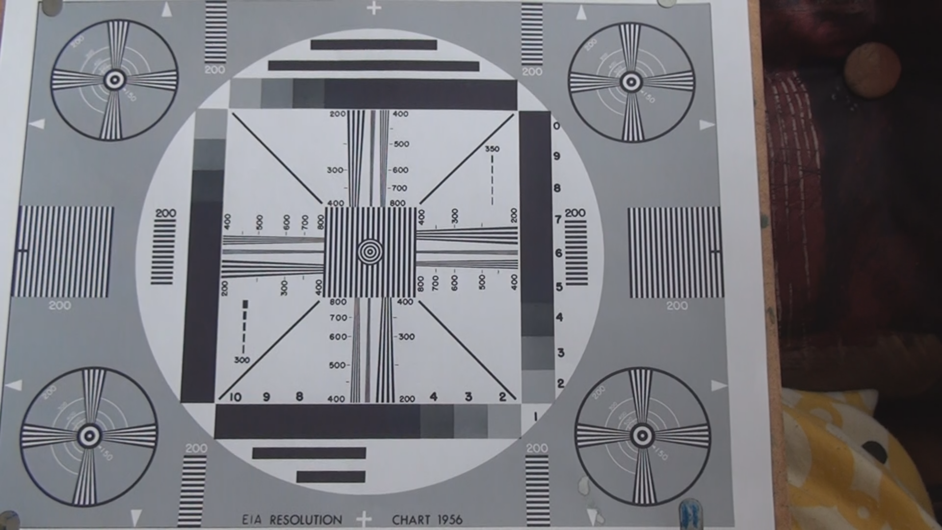

And my (not used anymore) HV10:
http://www.relaxvideo.hu/res-hv10.png
Pretty good from 1440x1080 source, isn't?

post #1264 of 1532
The test chart needs to be properly set up in order to do any meaningful comparison. You need to align the chart with the small white triangles at the edge of the frame in each shot. There are two for each top, bottom, left and right sides ( 8 total) It seems you either were unaware of how to use the chart or didn't care about getting meaningful test measurement. The chart must be placed so that it is not leaning back at the top nor shot off center at an angle. You don't need to compare the TD10 to another camera with different imager as while it may be fascinating it has nothing to do with the claim that the TD10 has less resolution in 3D mode than 2D. Also, when you pull a 2D still off the 3D TD10 all you are looking at is the same left camera in in both modes, so your mode for shooting needs to be the same also, mode in this case to mean the 2D has to be set to the same as the 3D since there is only one 3D shooting mode allowed ( frame rate 60i and size 1080x1920 and bit rate for a single left eye camera ) I'm not sure what the bit rate setting in Image/size selection in the TD10 menu would be. While there may be some reason for comparing the 2D image grab from a 2D shot, it would be better to compare the visual res test in a 3D image since that is really what we are trying to compare. This presents some tricky decisions on how to do that. Easier to do it for a 3D video clip of the chart and compare with a 2D video of the chart, but this is just to make the test more representative of how the cameras will be used.
What I can tell you is that when I shoot twin TD10's in 2D for stereo pairs, I set them for maximum quality in 24p which I know is a higher bit rate than the 3D mode allows. Then in post I am converting my few 60i 3D shots to 24p for the edit. So, yes, this in and of itself technically will result in a lower "quality" than the paired clips. But the real question is: How critical and how noticeable is that difference? I say it is far less important than the other aspects of my project which is 1. story line, 2. exposure, color match, focus, 3D parallax, framing, and sound quality, 3. overall presentation flow. I recognize that I am working with different cameras and shooting in different modes with the same camera. To me, the subtle differences in the resultant image are undetectable by my audience. But here I'm referring to just a philosophy of TV production, not the technical measurements of two different modes of operation of the same camera.
Bottom line to all this is pretty simple, From what you showed me in the tests, even though the chart was not properly aligned, the TD10 appears to be working within design specifications. If you feel the TD10 is inadequate for your work then I suggest you shop for higher quality equipment. If you feel your TD10 is defective and needs repair, send it in to Sony but from what I see I'm afraid your biggest challenge will be to convince the repair tech there is something broke that he can fix to your satisfaction.

Yes, i don't made it with properly setup, studio quality test, just a quick test, chart on my bed, etc. I placed the cam always so the top and bottom white triangles just doesn't go out of the frame.
But i don't think a better test environment can give another result. In fact, i record 2 other charts too, with exactly the same result. So i'm sure this is the reality, and this is what i saw with my naked eyes: the resolution is much lower in 3D mode than in 2D.

post #1267 of 1532
OK, Don you are right!
I was wrong. My statement: 3D is a lot softer than 2D is not 100% true.
(now i see a very minor quality difference or nothing)
What changed?
I captured the wrong view: the right frame.
Which is softer than the left!
The issue is also found here:
http://www.avsforum.com/avs-vb/showthread.php?t=1363453
I read that your cam hasn't this difference, you are lucky!
