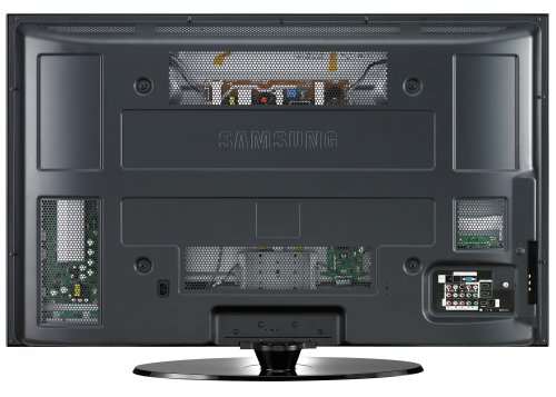

Upon doing so however, I encountered something I never would have expected... that being the actual female thread casings, secured inside the frame of the TV, managed to pull directly out of the backside of the TV. So to put things into better perspective, the 4 bolts used to secured the wall mount brackets to the backside of the TV, literally were extracted from the 2 support rails. At this point I was shocked-had no idea how I would ever be able to hang this again.
I decided to take the back cover off the TV. I found the 2 support rails each which 2 holes and a metal case set within. To my surprise there was absolutely nothing securing these inside the holes aside from the friction and what I can assume is a slightly smaller hole in the rail than actual diameter of the metal casing. With very little effort I was actually able to remove the remaining 3 female thread casings. Now I'm faced with nothing to secure the bracket/bolts to on the TV.

Back cover for ref
