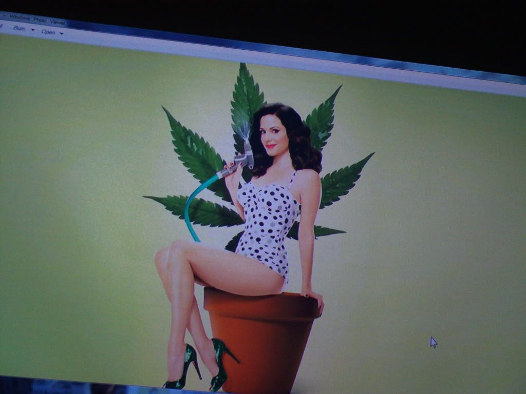

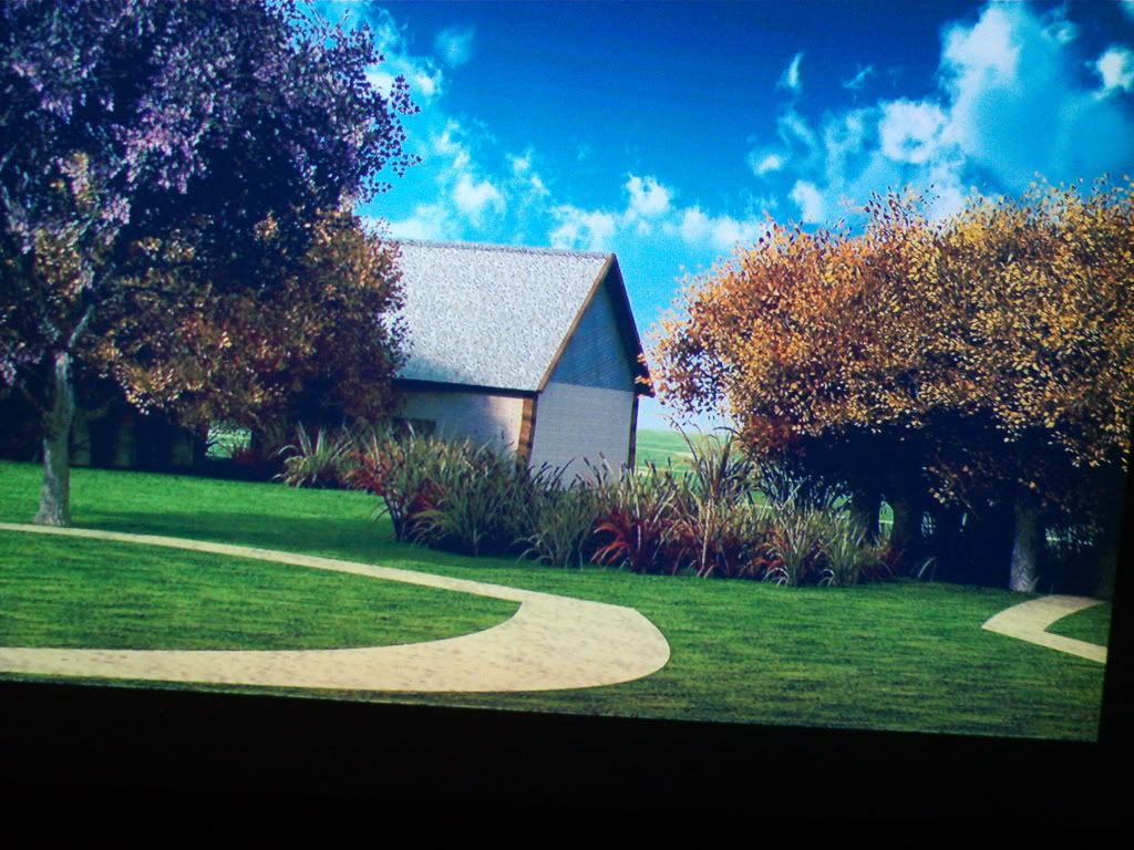

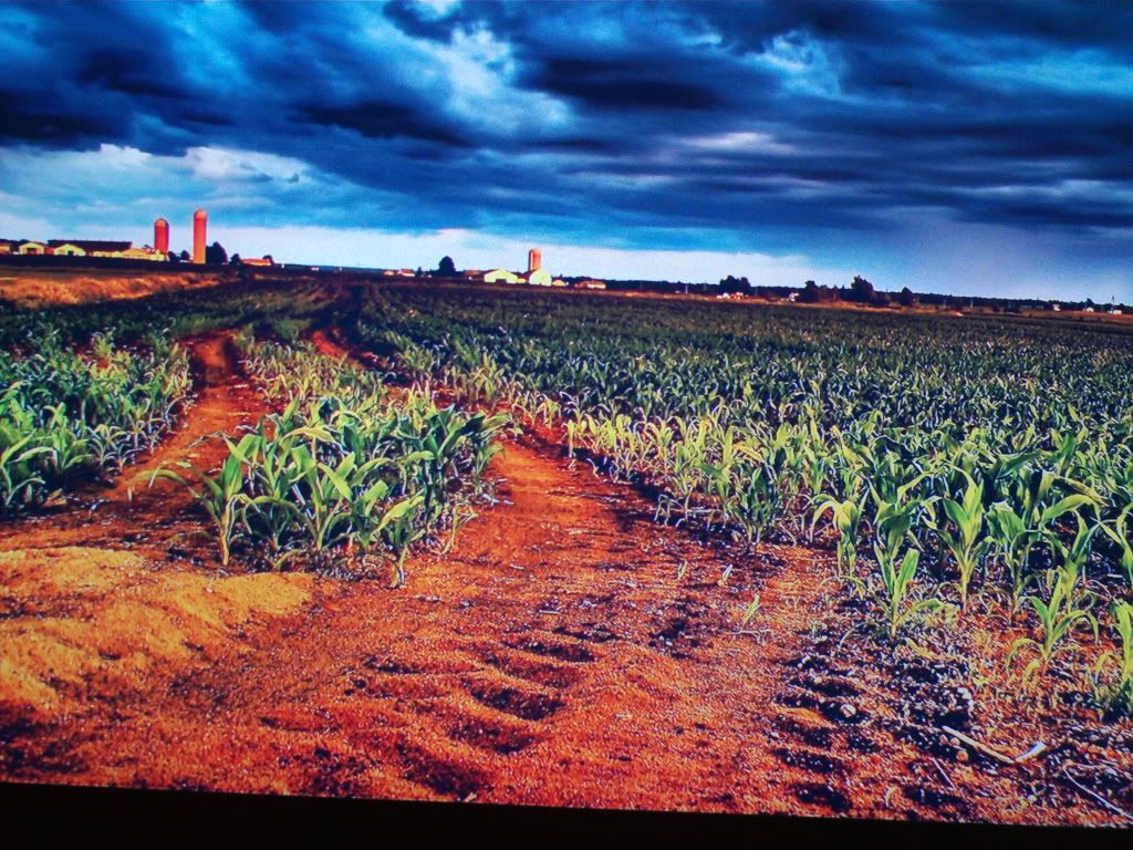

Heres 3 older pics u may enjoy(taken by me on an aiptek camera) of the CRE X1000 picture quality in full technicolor glory
please dont break, please dont break, please dont break.
