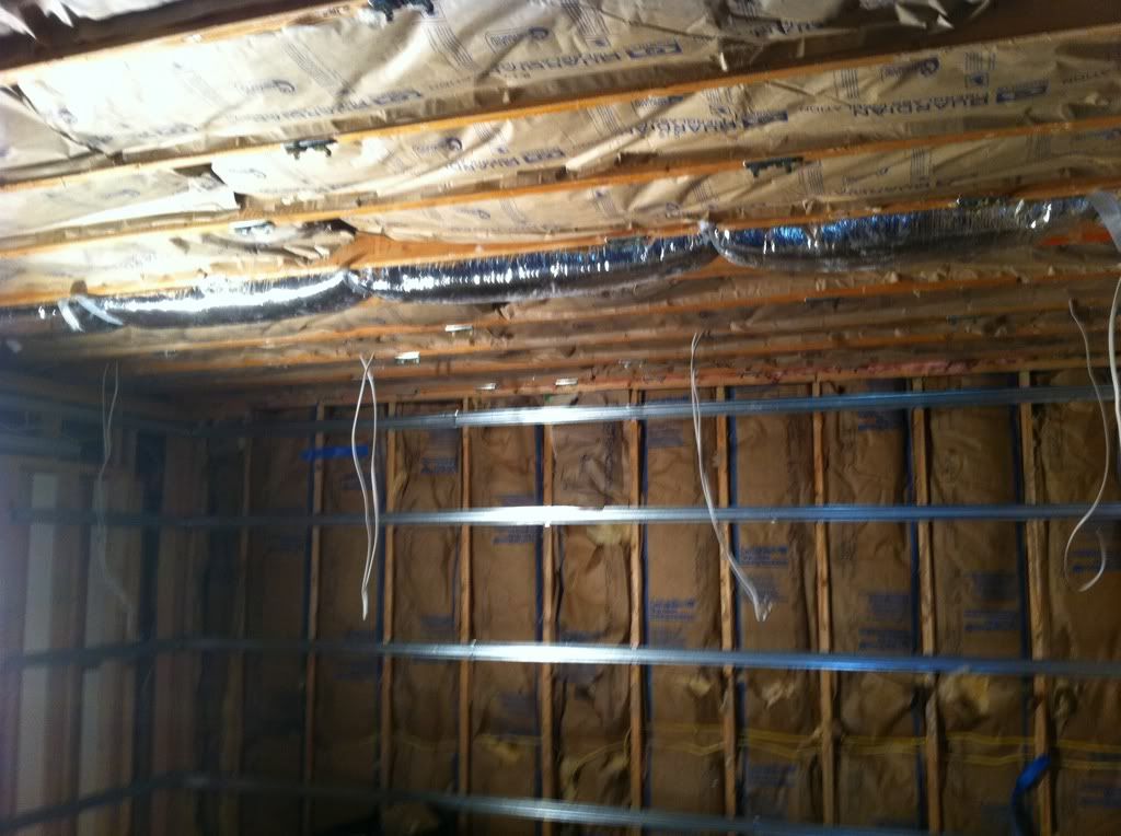

Insulated Ceiling
Nasty front joist- had to stuff pinkstuff in and around a duct, and capped off the end with a bunch of roxul - i'm still itching from the unfaced pink stuff

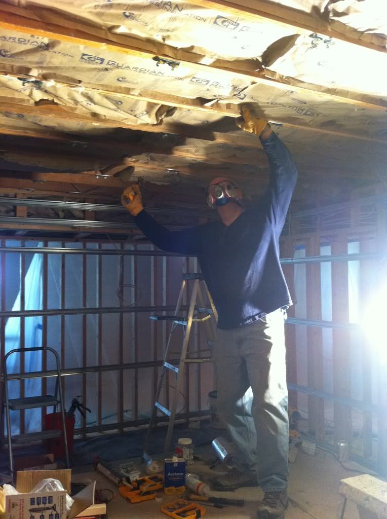

Mr. Big doing some damage with a staple gun (actually just securing hte insulation in the joist)

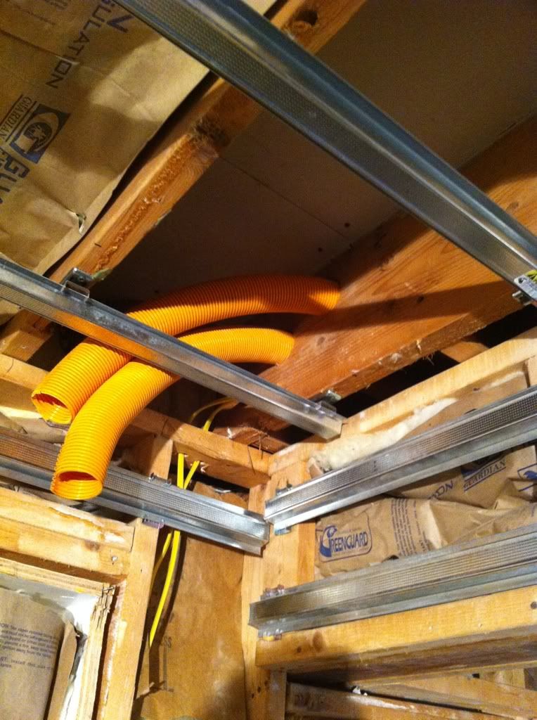

two conduit lines from the equipment closet to where the soffit will eventually go. you can also see the rear bulkhead here which we stuffed about 3 layers of insulation in - this bulkhead also ended up using a lot more clips than anticipated - need 12 more clips to finish the channel
conduit lines from the equipment rack into the room
Conduit line to the projector location
Need to update with pics of the whole room channeled - looks amazing

What height ceiling in there? I see Big is banging his head on the cieling, I think he is about 8'6" so you must have 9' ceilings?
post #132 of 565
Lol - he's standing on a stack of drywall - ceilings are about 8'
post #133 of 565
Must be the forced perspective of the photo but it looks like he is a giant of a man.

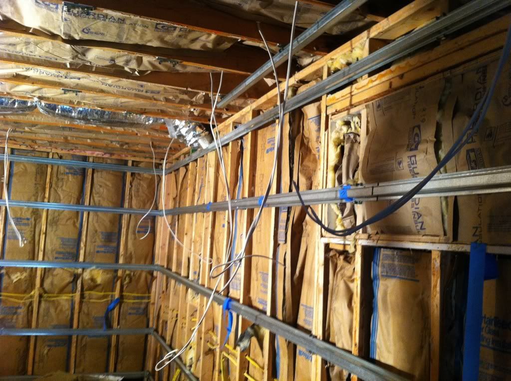

one other thing i forgot to mention. In order to install the channels we had to add extra 2x4 studs in the corners. This allowed us enough room to keep the channels from butting into each other or the perpendicular wall
Found a good picture of this, also check out Jesto's new laser level shining a line for the bottom row of clips on the wall.
Another picture of a clipped and channeled room:
