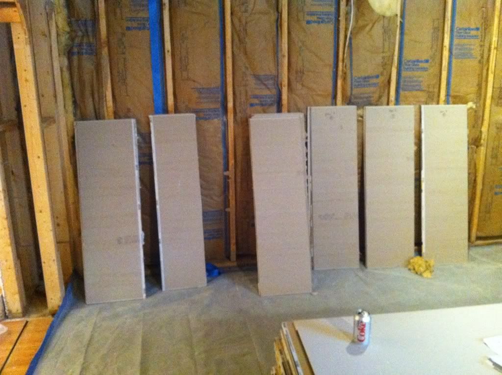

Drywall, green glue, clips, applicator - waiting in the HT room to get started
Ceremonious first cut
Goal here is to apply 2 layers of gg/dw to the subfloor above. One thing i've discovered is that the joists seem to have space between them anywhere from 14" wide to up to 15.25" wide - crazy
After trying to custom cut about 2 rows perfectly for the joists - i've just given up on that (mass is the most impt thing on this layer anyway as far as i know)
in the interest of time and my sanity, i've decided to stick with 4' drywall strips of about 14 1/8" and then i'll stagger and caulk as necc to create a good sound barrier

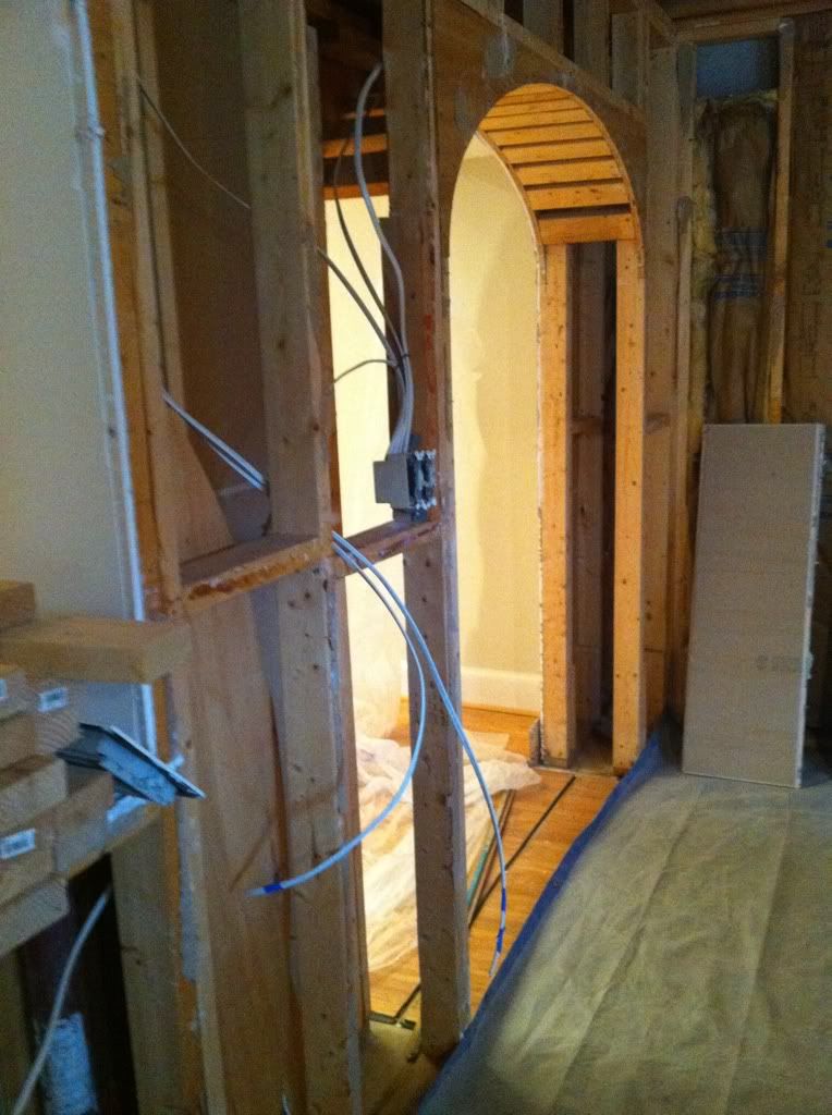

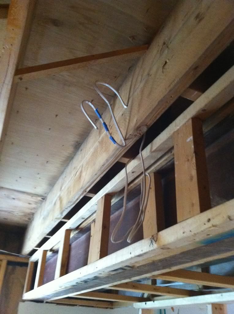

Last weekend we made some significant progress.
I've been fortunate to have the help, guidance, and mentorship of the masterful Mr. BigMouthinDC.
Last week I believe we came up with good plans for wiring and HVAC - and we were able to get the majority of the Romex run for the room including
  1. 2 15amp supply lines to the primary lighting switch location
  2. Wiring in place for all major lighting zones (Room, Stage, Riser, Specialty)
  3. 1 20amp supply line in place for the subs
  4. 1 15 amp supply line for projector
Everything on the wiring front is running to the location of the future sub-panel which should be getting put in this weekend.
Here are some pics of the wiring (I know, not too sexy, but i do like the cobra like line we ran for the projector)
Also completed during the week: the framing for the room is now complete with the double stud wall for the left side now framed with the door opening and the rear staggered stud wall completed

Made some progress yesterday - once again with the masterful guidance and assistance of Mr. Big
Here's what we got done:
  1. Cut all of the 14" drywall to go under the ceiling joists (100+)
  2. Installed 4 rows of the first layer of GG/DW
  3. Added a 6" junction for HVAC Supply Line #2
  4. Ran the HVAC return line to the utility room
  5. Cleared out all the nails in the ceiling
  6. Figured out the hopefully final plan for the sub-panel
  7. Snaked the line to bring in the Cat6 for the control panel and run the front of house security cam through the HT
  8. Drew first blood
About 1/2 of the 14" boards - of course, once we started installing we realized that ALL of the joists are spaced differently, about 1/2 of the rows were too narrow for even the 14" drywall we cut - so - we'll have to trim a bunch down some more
Here is Mr. Big installing the first board - I actually found the green glue easy to work with - hardest part was just figuring out how much to put on each board (figured about 1/6th of a load for each one - consistently applying that is a different story)
First blood - just a dinky cut from a nail that we missed in the ceiling - i'll post a pic when i draw real blood (which i'm sure i will based on my construction skills)
