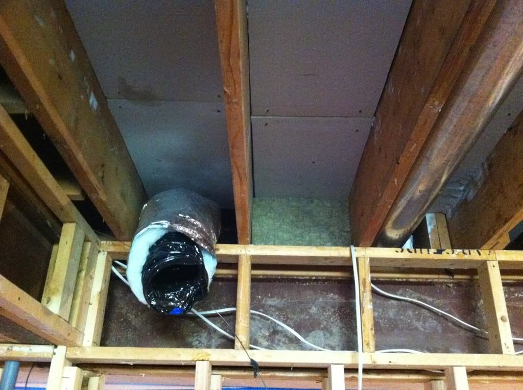

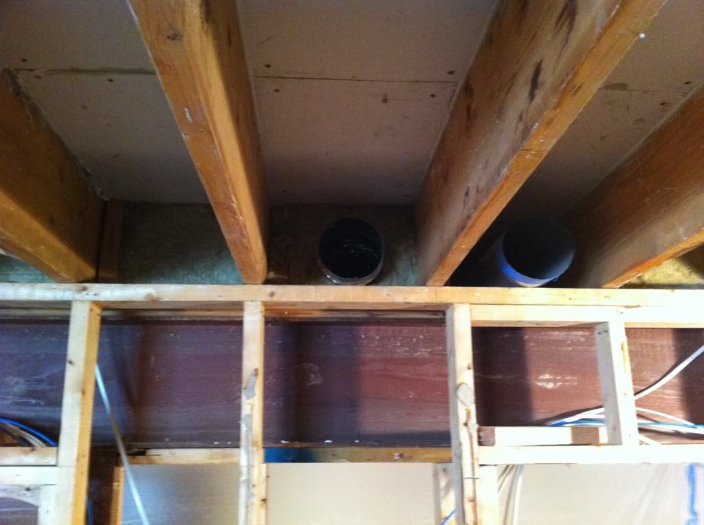

Some highlights from yesterday:
One area of concern was these disappearing joist cavities above a beam heading away from the theater.
We weren't going to attempt to stuff with insulation or plug each area off with a drywall plug so we grabbed some 4 inch compressed ROXUL to build a "fiber wall" not that we expect 100% sound proofing but something to take the edge off, The stuff does have over a 1.0 NRC even at 125kHZ. After all we are building a Room within a Room with clips, channel, GG and 1 1/4 of drywall on ALL the walls and ceiling so what sound that makes it toward these cavities should already be mostly reduced.
We put metal sleeves on the flex duct to pass through the fiber wall. Similar approach will be used to bring the ducts through the drywall ceiling inside the soffit.
There used to be a window, we put a shade in the down position, some furring and then plywood. Insulation and framing to follow. Will get covered with drywall. Theater building is a family affair, that's Jesto's future brother-in-law playing with my impact driver. He liked it so much he was already talking about buying one.
Jesto and company got some clips and channel up, should finish today.

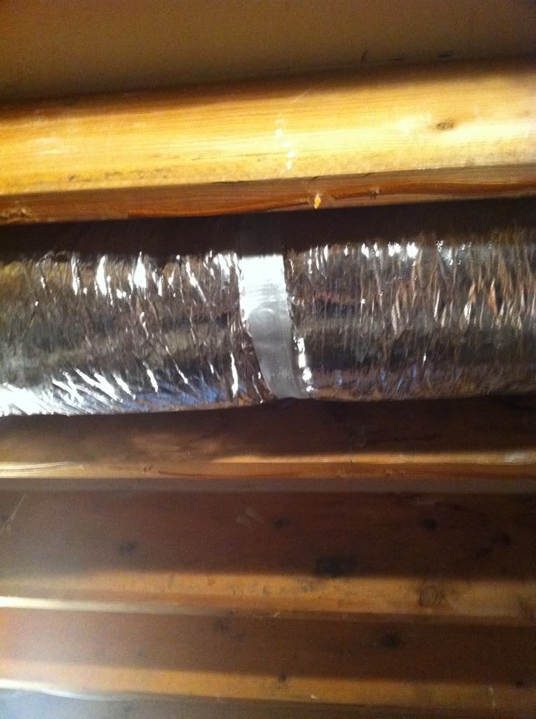

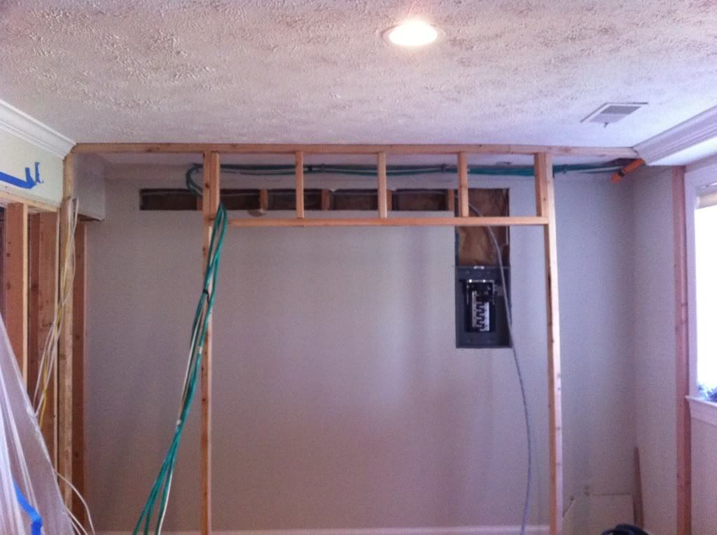

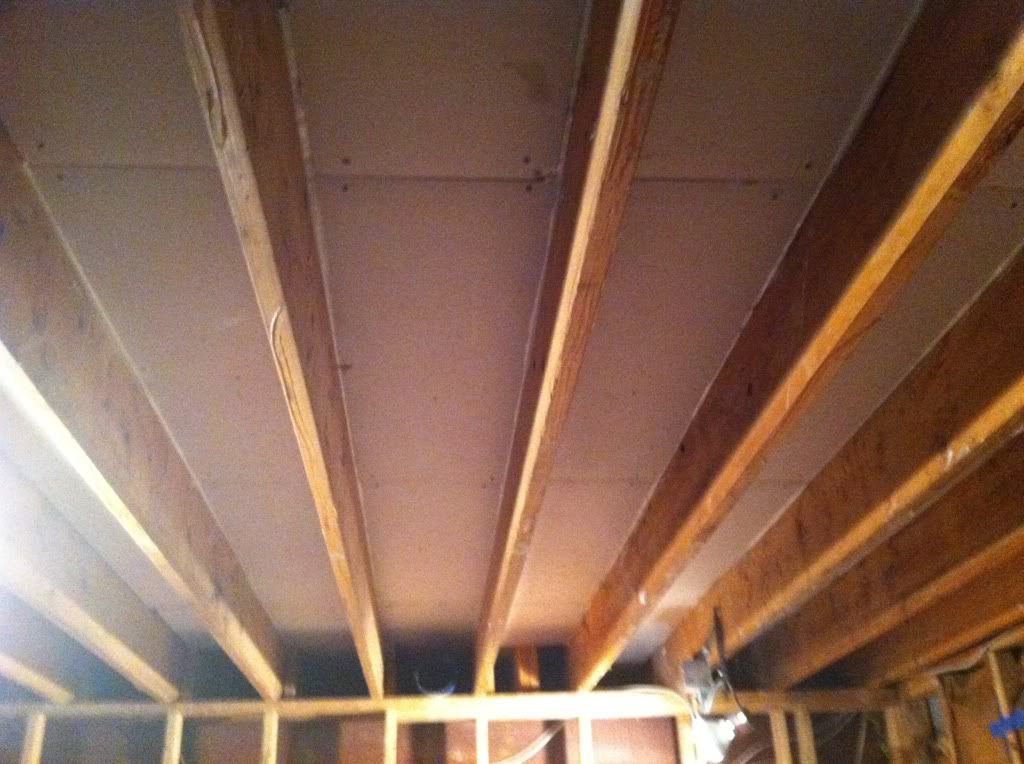

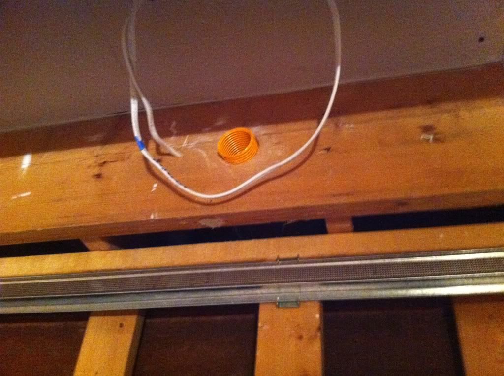

Another day of big progress
  1. Sub Panel is in and the majority of theater wiring is done - this is being done by a friend of mine that is actually an electrical engineer and is being done to "commercial standards"
  2. almost all the clips are in for the walls - one small problem - we're aobut 6 clips short for the walls - guess i'll be calling Ted first thing in the morning
  3. Most of the furring channel is in on the walls - just need to connect the strips now with the self-tapping screws
  4. HVAC is done, and working well thanks to Mr. Big
  5. I had a minor moment at Home Depot today trying to pick out recessed lights that we could run with electrical - gave up and bought little ceramic bulb holders for now
Here are some pics
Heres the flexiduct we ran across the theater for one of the supplies
This is the return line we ran to the utility closet
Sub-panel - ended up running a 60amp b/c thats the most we could pull without really rearranging the two 200amp boxes - we actually ran it to a 100amp sub panel because it has a lot more slots - but its a total of 60 amps- so far we've figured - 2 15amp lines for the lighting (1st line is for overheads - 2nd for accents), and 2 20amp lines for equipment (1st line for subwoofers and 2nd for eqiupment in the closet)
Furring Channels all in - at least for the walls - still need some small connectors, and silly me forgot we need 2 layers over the door - actually ran about 6 clips short
and....
conduit to the projector - YAY - next up - need to run the conduit into the room for the future runs through the soffit
We'll need to figure out how to get the majority of the A/V wiring, lighting, HVAC through the future soffits.
Oh - and one more pic of Mr. Big's ingenious work on the HVAC - it really is an elegant solution and looks awesome when you see all three of the holes (2 supplies / 1 return) through a "wall of roxul"
and another of the drywall under the joists
room is already getting quieter

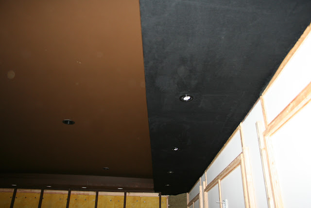

Jesto here is an example of a 4 inch recessed fixture that is rated IC (in contact) and we should be able to fit it inside the soffit size you have in mind. Another thought about a way to get more light in the theater without sconces and in-ceiling cans would be to put some (3-4) of these 4 inch fixtures in the soffit over the screen, use the eyeball trims to aim at the screen and the light will bounce back into the room. Put that as zone 1, in your lighting plan. Double up the first two cans on the sides in zone 2 and the back on zone 3.
http://www.cooperlighting.com/specfi...CAT%20spec.pdf
For those pondering the lighting in this space Jesto is also planning a cornice molding rope light at the ceiling.
post #79 of 565
can you put non-ic in the floor joist area as long as it's not touching insulation?
Thanks, Brad
As usual, I like the plan - maybe just blatantly copy brad's design from his pimped out garage (but without the ceiling lights?)
post #83 of 565
I previously asked Brad about those exact lights and they are stocked at Lowes/Home depot. They are 3 inch and not intended to be in contact with insulation. But if you leave sufficient gaps they should work. They use a "funky" bulb.
Looks like he used one every 2 feet.

I forget the exact spacing, I measured the distance from end to end on the wall, and divided by N, where N = number of fixtures (end fixtures get 1/2 the spacing). The bulbs are 50W GU10. I cut the insulation away around the fixtures several inches. They come in chrome or white, so you'll need to paint the trims if you want black.
post #86 of 565
Don't forget that we need some room for the "dead vent" set up in the soffit.
here is a version of the light at HD
http://www.homedepot.com/Lighting-Fa...atalogId=10053
post #87 of 565
Brad - do you think the lights around the perimeter and a rope light in the soffit would be enough to light your theater?
or do you think the ceiling cans are necessary as well?

About those 3" lights. I have them in my soffit on teh sides and use them as my screen lights. They are inexpensive (about $20), but the halogen bulbs that come with them put off a lot of heat. I need to replace the bulbs in mine with something that doesn't get as hot and that is dimmable.
Just something to consider.
