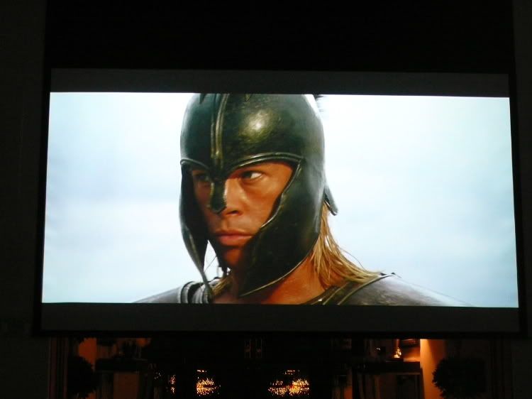

Here's some screenshots of my Epson 705HD with SF 2.5 2.0. Not the greatest camera, so it's not totally accurate.

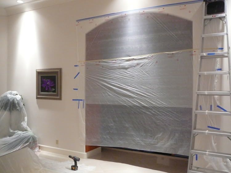

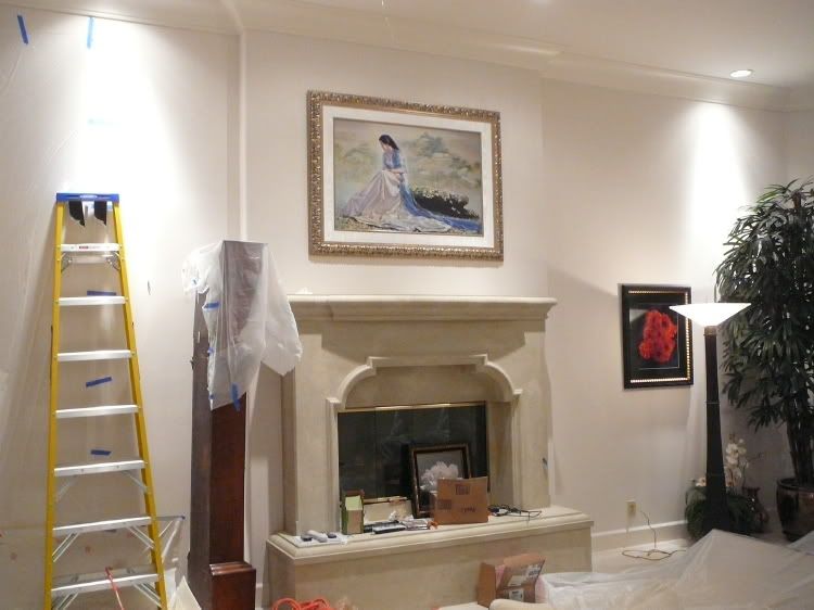

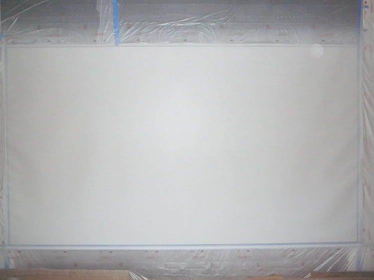

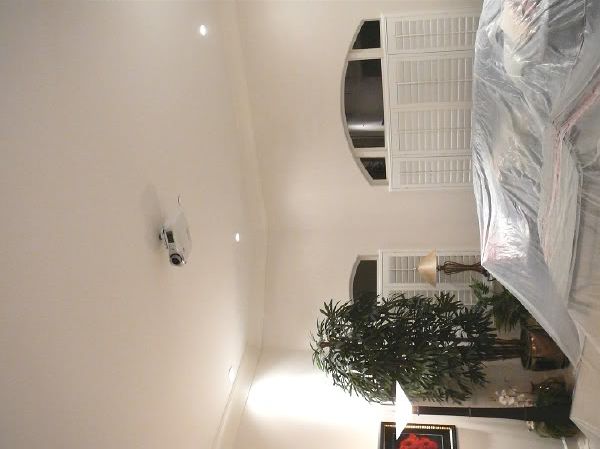

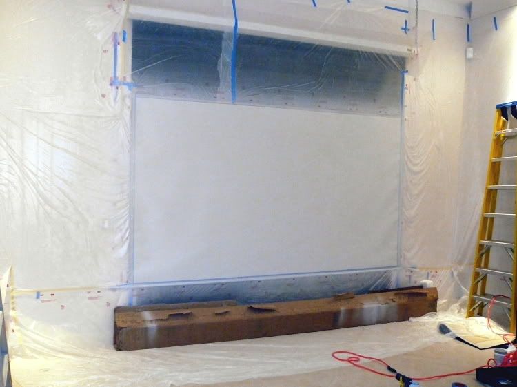

As what I read here, most SF mix was applied on Sintra or wall, have anyone actually applied SF mix on a retractable screen? mind to share some pictures & review?
post #748 of 1125

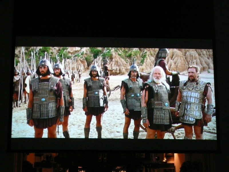

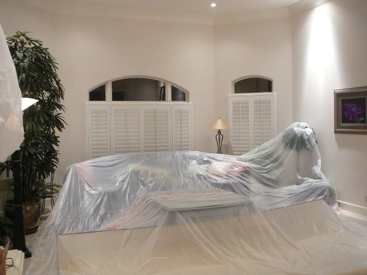

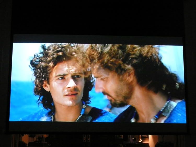

Here is a big 'ol 120" DaLite Matte White Electrol Retractable in San Diego, ensconced in a Hacienda-like home in Rancho Sante Fe
It was a "original formula" Silver Fire 2.0, "Dusted" on using a lowly old original Wagner Control Spray a-way back in 2009.
The home was one of those +$4 Mil jobs, with the Furniture in the Formal Living Room costing as much as many peoples yearly salary, so the decision to paint the Screen "inside" was not one I made lightly. Fur Shur....if I had been using a Tank/Hose/Gun HVLP Rig, it would not have happened, nor would I have considered Rolling it (Silver Fire) on since that would have been inadvisable.
As shown, the Walls & Ceiling where a bright Flat White, but fortunately the Ceiling as 12' high and the Side Walls were a good 3' & 5' away on each side of the Screen, so there was little chance of any adverse re-directed reflected light from the PJ to worry about washing out the screen's image.
So the first thing in order of doing was to liberally mask off the area where I was going to temporarily hang the Screen with chains (...eventually the Screen was located behind a built-out section of Crown Molding...) so it would be low enough to effectively reach without a walkway platform.
I covered the strange, skinny Clock, but not the Stone Hearth or Picture, knowing that the "Maid" would dust them off.
However, you betcha a draped every piece of Floor Furniture....
......and every bit of the $150.00 yard Carpet!!!
BTW, that is a Epson 1080UB a'hangin' way up there at 17' away from the Screen
Let the coating commence! (...sorry, no Video, but it was a standard "Duster" procedure w/no primer applied beforehand...) You will note that I taped over the Black Surround using Painter's Blue Tape, then I taped over it again and attached the outside edges of the Screen to each side of the 10' case opening.
1st Coat
2nd Coat
Final Coat after drying.....and under "Flash" conditions
Side shot w/Flash taken from 2' away from the left corner.....
So how'd it turn out?
You tell me......., (note: Screen is now hung at proper height)
When I was done, I simply gathered up the thin plastic (9' x 12' sheets of .7 mil ) into a wad, picked up my "Wagster", and faded off onto the Beaches, where I consumed mass quantities of Anchor Steam Beer and contemplated the wonders of "String" theory as they walked by.
The Universe is a wonderful place to be....leastwise when your at the beach.
