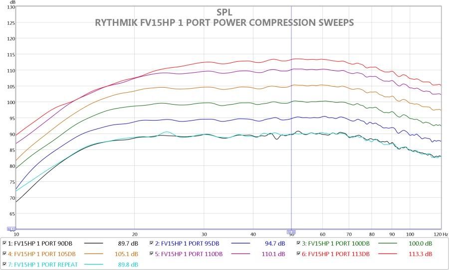

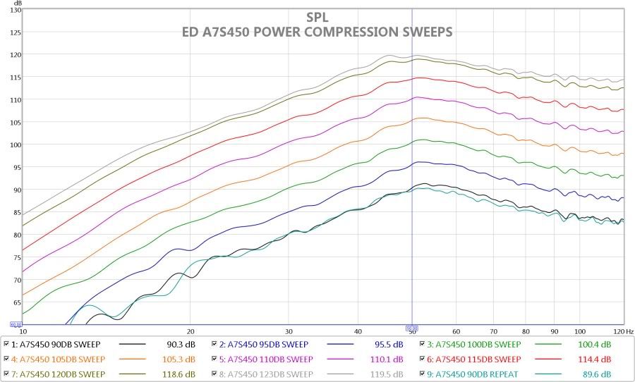

The response of most subs I've seen measured does change when you reach the limits. This can be caused by reaching excursion limits, limits of the port, amp limits or a limiter or protection circuit. Some change more than others. Here are some examples.
This is why I think it is important for people to not only measure their response at 75 or 80db, but keep raising it until compression. This will give an idea of the limits of your sub. Something else to keep in mind is these max output graphs are not necessarily the max short term output of the sub. The peak CEA2010 numbers and what you can reach during movies or music will probably be higher then the sweep numbers. One other thing you can see from their measurements is when the response starts changing, most of the time distortion increases dramatically.
I don't know if that answers your question, but look through Ricci's and Ilkka's measurements and you can get an idea of how the response of different subs change as the levels are increased.
-Mike
post #1125 of 1241
-Mike
If Ricci used the bass boost and got rid of the HP filter(both can be done from eD) it would be much flatter and had very little compression with the 120 db sweep. Impressive, no wonder my 8 eD sealed system moved some serious air.
The eD would exceed max excursion without the HPF, model it.

Alex said he thinks it's ~17.5Hz. Assuming 2nd order butterworth I think they could go as low as 12Hz with it. He also said he's seen L/T1300s put out as much as 1600w, so they have to make room for that scenario. But even with the 17.5Hz HPF I model over-excursion with the 25Hz boost +3dB... so, I really don't know what they did here, or what else could be done besides the obvious.

I think I have mentioned it before, but another thing that can be done is doing sweeps at increasing levels until compression occurs. Just like the graphs I posted earlier. This will show if any sub starts losing output at specific frequency ranges at higher levels. Just because a sub has the most output below 20hz at 80db, doesn't mean it will still have the most at over 100db. IMHO, this type of measurement would be a great addition to any shootout, comparison or review.
-Mike
post #1140 of 1241
-Mike
I agree 100%. Compression sweeps are fun too. Very easy to do once the 85 db sweep is peformed. Just keep turning up the 5 volume 5 db increments until you see compression. My CS subs went to 5hz at 85 db's and went flat to 10hz once I turned them up 10db's. The 5-10hz compressed and everything else did not. I agree with Pete as well because the rs meter will not read high numbers below 20hz but will register high when a 25hz or above hits during the same scene.
