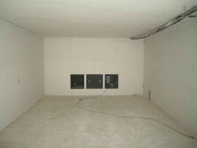

Both layers of drywall are up.
Congratulations. That's a big milestone -- some would say you are half way there but my experience differs. Looking great!
