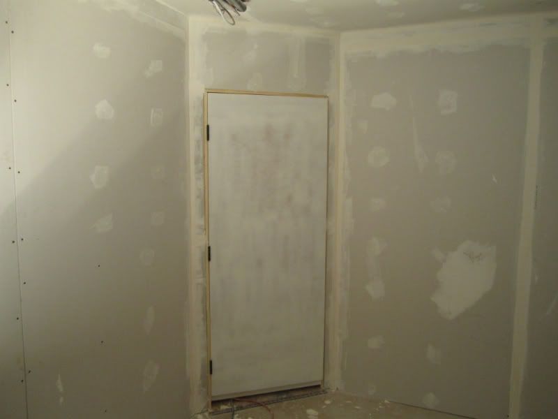

The door has been hung. I put quite a bit of reinforcement around the jamb particularly where the hinges go. It doesn't appear to have any sag so I think it is going to hold up. It is a very heavy door though. I still need to install the threshold and door seal.
It looks like the door is sagging a bit in this picture, but the door is just opened a bit which makes the bottom appear uneven.
