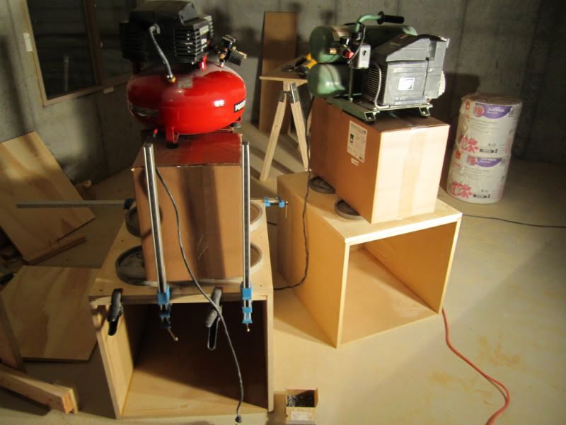

Starting the second layer on the sub manifolds. Piled on some weight for clamping.

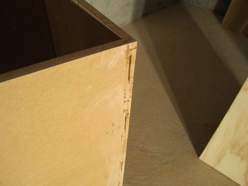

Here is my mistake with the biscuit jointer - made the joints on the wrong side - These will be covered by the second layer so I filled them in with bondo.
