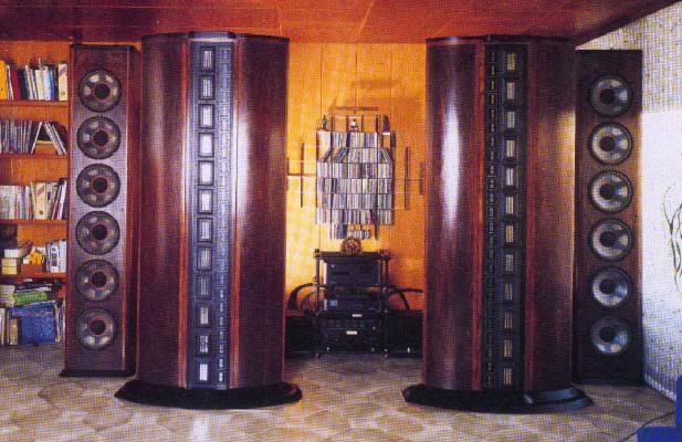

I hear you - I'm sure you can speak to that better than I can. I've never heard an IB yet - But from what I understand it is a different sound that most are used to due to the lack of distortion and because of the lack of distortion some say they do not sound as loud to some people as a conventional sub.
I hope that you are right and I have no desire to upgrade - 4 18's is probably considered excessive by many, but this is the way I look at it. - I remember in the late 80's I went into a high end stereo store and they had the Infinity IRS Beta's - The IRS Betas were $70k if I recall correctly and this was a time when $5000 speakers were considered extremely high end. The IRS betas had two towers with 12 - 10 or 12 inch woofers in two towers and they went down to 16 hz. They played an organ note at 16 and it totally pressurized the room. I was amazed by those speakers.
Those Infinity drivers of that era probably had 8-10 mm of xmax if that - Now you can get the equivalent displacement with a few 15 inch drivers and just about everybody these days with a subwoofer has 16hz extension. The Infinity's seemed very excessive back then (and they were), but looking at them from today's perspective the output does not seem as impressive.
One other thing - each halving of frequency requires 4x the displacement for equal volume - Lets say hypothetically My speakers with dual 9" scanspeak woofers can output 110db at 40hz and have 1 liter of displacement - to have the same output as the mains at 20 hz - the sub would require 4 liters. 16 liters at 10 hz, 64 at 5 hz etc. (the 4 fi 18's have 29 liters of displacement) When you start to look at it like that maybe 4- 22's does not sound so crazy
I'm not interested in cranking out 130 db's at 20 hz. I really have no use for that - I want the subs to be able to play low and free of distortion and driving them well under their limits.
This is the Infinity system I was referring to (this was just a photo pulled off the web)

Now that is devotion to the bottom end! Excessive? When you are trying to reproduce the power of an earthquake or a nuclear explosion in the comfort of your own home you need to go to extremes. My little 10" sub doesn't even hint at that type of subterranean rumble. Looking forward to watching the rest of your build. Seeing the pictures of the Infinity's brought back some of that old hi-fi nostalgia. I remember reading about them back when I was saving $500 for my first set of bookshelves. Yup, the price tag was excessive, but still the object of many budding audiophiles wet dreams. Altec Lansing had a series out at the time that was almost as crazy. Can't remember the name but it was a monster tower vertically loaded with large drives, bigger I think then the bass tower of the Infinity's. It was an active speaker, with a five way cross over if memory serves...and where is Altec now? Making $50 computer speakers. Sad really.
Where is infinity for that matter? - Back in the late 80's Infinity and even Polk made some good stuff. The speakers from that era are much better than what they put out today. In the late 80's (still high school for me), I dreamed of owning the Polk SRS-SDA 1.2's. I remember listening to these in the store and being amazed at the 3d image they provided.
