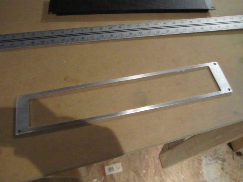

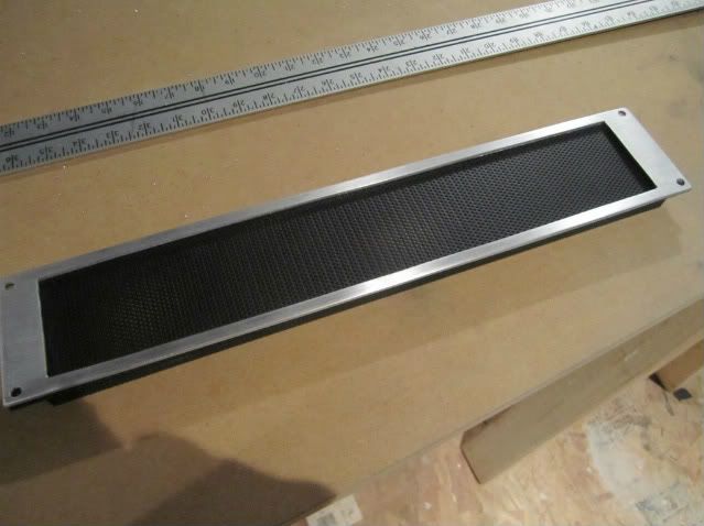

I started experimenting with the face plates for the equipment rack. I wanted to see how thin I could make the edges while still retaining some strength. At 1/4 inch it does bend but is still pretty strong.
I used this piece for a trim around a 2U vent panel. This is just so the vent matches up with the rest of the face plates.

Face plate looks great!

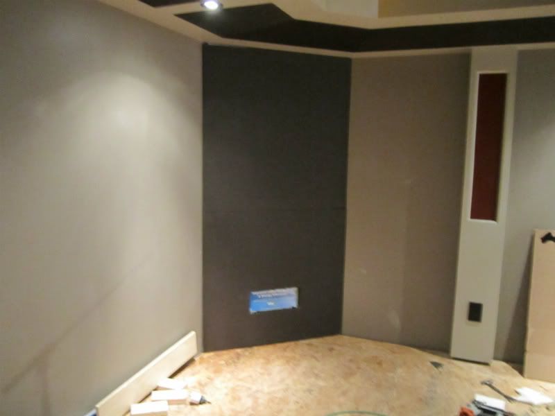

By the way I never posted a picture of the corner bass trap. I did not like the look of the corner with fabric covering the entire corner. This would have looked fine if I had decided to do all the walls in fabric but I went with panels instead. I ended up putting drywall on the corner and painting to match the rest of the walls. I still plan to put up a panel in the corner and will cut out the drywall behind the panel so it still acts as a large bass trap. I will not get as much surface area with the trap this way, but cosmetically it will look better.
Before
After

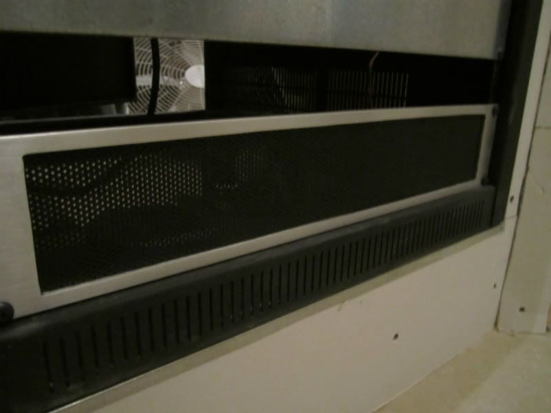

Here is the finished faceplate painted and installed in the rack.

What are you using to cut those a CNC? They look awesome!
post #762 of 1093
I cut with a jigsaw and filed it smooth. Its not as perfect as it looks in the picture, but you wouldn't notice the issues without looking carefully. The ones to fit the components are going to be harder to make.

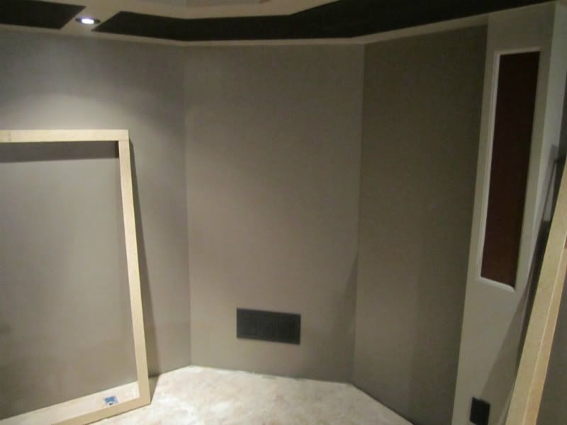

Its been a while since I had the room cleared out to take some decent pictures. Here are some shots of what the room currently looks like. Still waiting for my screen to finish up the screen wall and I'll be ready for carpet.
