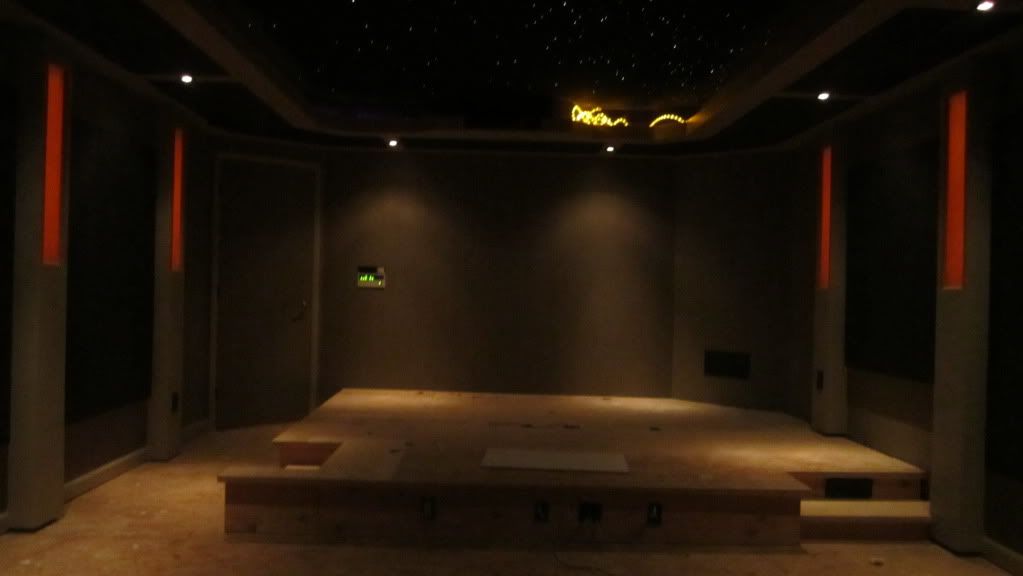

StkMk2k - looks great! How about a pic from the stage.. to see the seating area...
Here's a couple shots toward the seating area. Its hard to get a wide angle shot from the front. I had to stand outside the door for the other pictures. As you can see I still have not cut my amber rope light to fit so it is just tucked up in the light tray. My photos are a bit crooked. I need to invest in a tripod.
