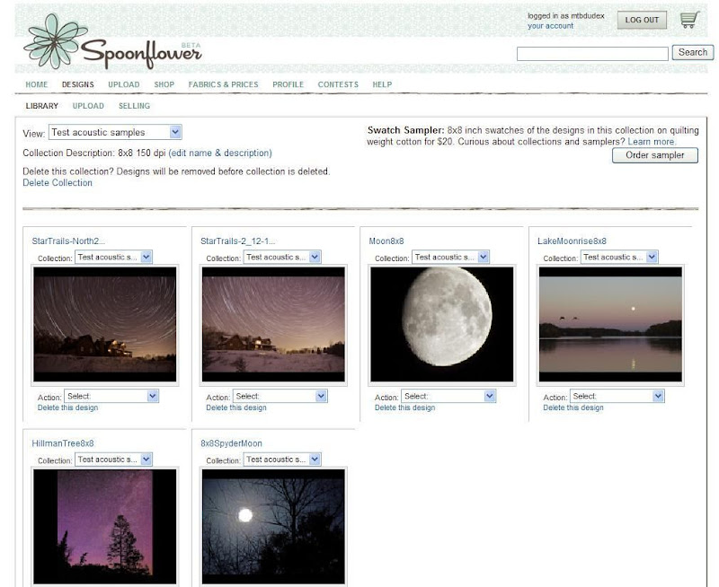

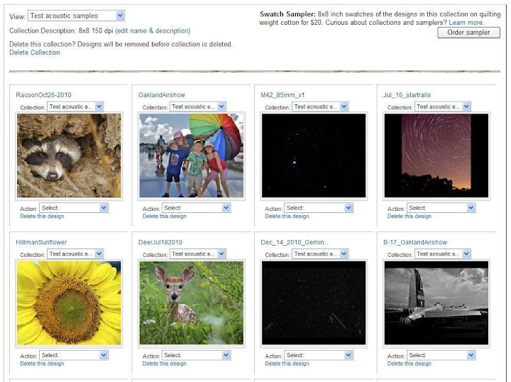

Finally, you need the printed poster! For this you are going to need two things: some source artwork, and somebody to print it on fabric. You can find source art all over the internet. If you don't mind spending a couple dollars this can be a good source. Otherwise, google image search can be helpful. You are going to be blowing this up to poster size so you are going to need high-resolution images to start with. Anything under 1000-2000 pixels high is probably not going to look too good. In my case, I selected a series of four posters from the movie Goldfinger, blew them up a bit with third party software, then touched up the final results to smooth out the resulting image (having a professional photographer wife helps with these steps).
Next, you need to get this printed. There are loads of shops that offer digital canvas printing - you don't want this! Canvas prints are great for art reproduction, but are very thick and won't transmit sound to the material inside at all. What you want is printed fabric. Your options may vary depending on where you are, but I found Spoonflower in the US and they are great! They have a variety of fabrics, a super-easy to use website, and can print large-format fabrics for cheap. The site also allows you to share posters you've uploaded. You can find mine here and here. You can order a fabric sample set from them to get an idea of what the options are. The fabric needs to be thin enough to transmit sound while still being thick enough to allow a decent print. You'll want to stay away from stretchable materials as they will be nearly impossible to mount. After reviewing the sample set then ordering a couple printed samples, I've found that the standard "quilting weight" fabric offers the best balance between print density and acoustic transparency. [update: mtbdudex is a stud and tested the Spoonflower "Quilting Weight" fabric for acoustic transparency here. Short version - it works great!] My order for the 4 posters came to $36 shipped and arrived in about 2 weeks with standard shipping.
