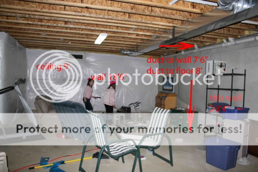

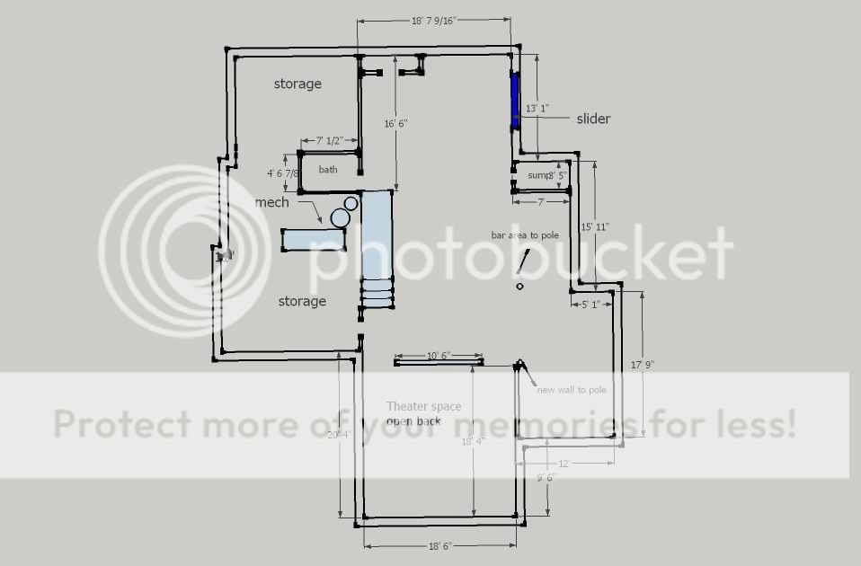

After lots of reading on this site I'm starting to finish my basement. Plan is for an open concept due to WAF. Screen on one end in "u" shape, back open to rest of basement. Going to separate the screen area from the rest of basement via soffit and bar counter
The foundation wall on the right side facing screen is the outer boundary. This will give me roughly an 18-19 foot deep space and ~17 ft wide. Was hoping to fit 2 rows plus bar counter- 2nd row on riser.
My dilemma will be screen size- wide space but not deep relatively. Given recommended riser depth of ~7ft my front row will roughly be in the 11Ft rane
Here is the layout:
The wall where the screen will be is where the window is:
Going to move the ductwork over to the right to make the ceiling higher.
On the left side going to extend the wall to the pole to make the U shape:
Plan:
I know this aquarium has a big hole but for futureproofing I'm going to decouple the walls and ceiling in this end of basement. Insulation in ceiling in whole basement and more wall insulation

TRying to plan lighting in theater area.
This area will be 18.5 feet deep, 17 feet wide
Need a real soffit on one side(18.5) for existing AC duct- roughly 16 inches wide
Was planning on fake soffits all the rest of the way around
Was planning on 3 sconces on each side, high hats in soffit up front lighting screen, high hats at rear over counter, rope lighting in middle
Is this enough? Other thought was to put high hates in fake soffit on one side, Assuming shoulsn't put high hats in real soffit on other side but build fake soffit inside of that for high hats?
THoughts

Ok framing is completed except for a couple of minor things in my open room concept.
Width is 17'4" inside faming and 19' deep.
Front wall showing blue tape of 120" diagonal screen(105" wide, 59" high) 16:9. My problem is I can go bigger in my screen but my first row will only be 11'5" to eyeballs before riser:
I can't do false wall and transparent screen due to depth and I plan on hiding speakers in a proscenium.
Any comments here?- was thinking of keeping same height and going wider for 2:37 layout
Back of room open to rest of basement- soffit is the split to rest of basement
