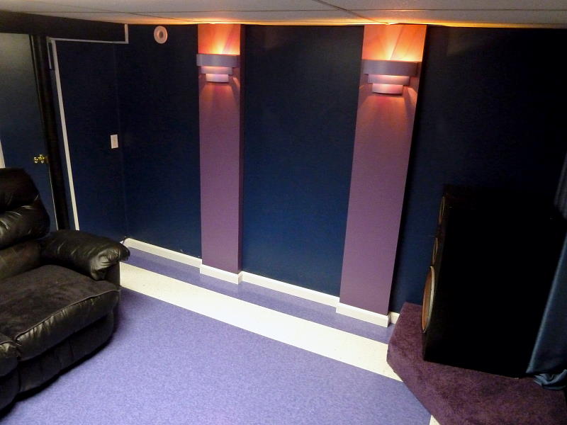

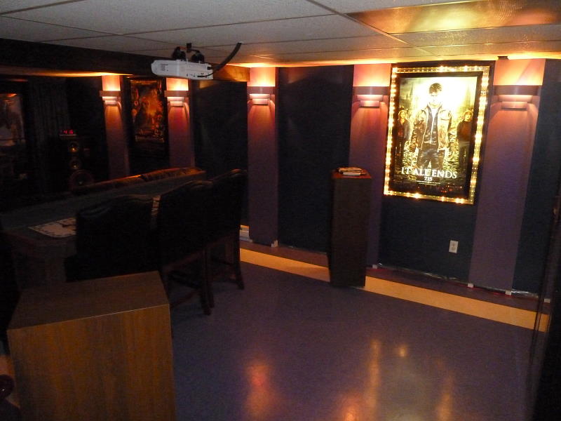

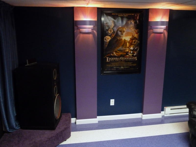

THREAD REVIVAL: Well, I finally installed my wall columns - constructed with 2x3 framing and 1/4" hardwood underlayment panels (hard and very smooth finish) from Lowe's. My theater room area is 13'x25', so I have no issues with people bumping their heads on the sconces protruding from the columns. I still need to install some of the baseboards and all the crown moulding on the columns, but they are looking mighty fine so far to me...

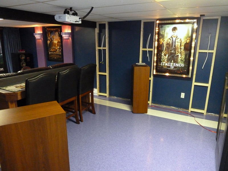

I finished framing my columns with 2x4s but I am having a problem figuring out how to add removable picture framing with fabric to hide speakers. Any help is appreciated!

What is all that framing for? Rip it out. build three sided boxes with MDF, wrap in fabric and staple on the back edge, Add speakers, stand in place on the wall, screw to blocking, then add what ever molding on the front you want,
post #19 of 20
I'm going for this type of look.
The framing I have in place should be good to attach MDF to for a strong box. I just need to make the fabric panels removable
