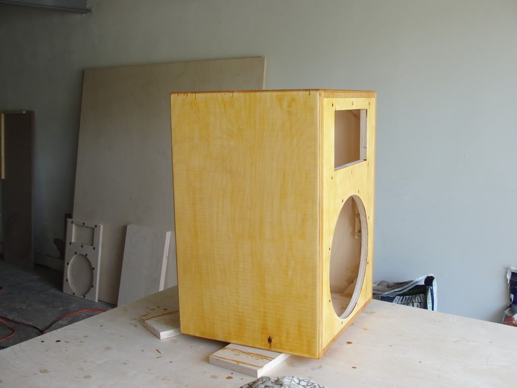

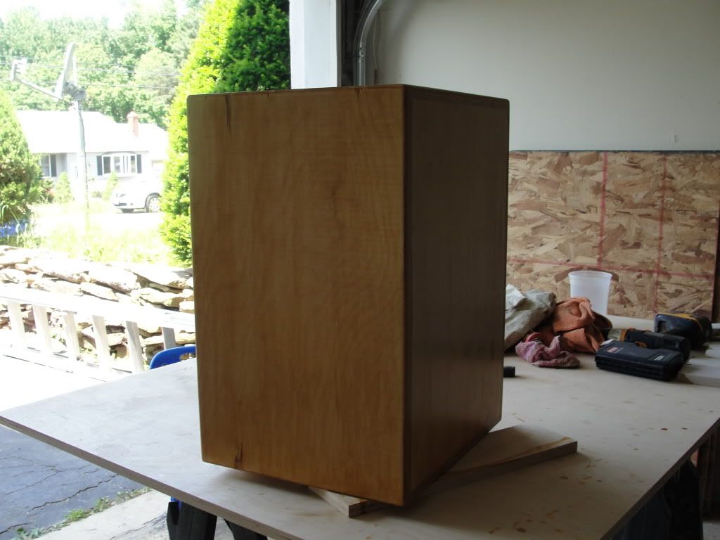

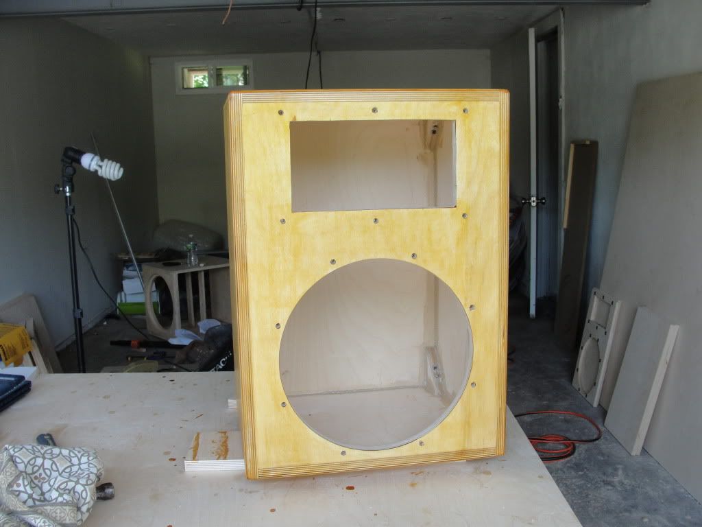

almost ready. this is after a few rounds of amber shellac and sanding.
you can see some of the cracks/chips near the edges.
i kinda like the clear shellac more than this amber. i know it darkens the woods, but it just doesn't seem to bring out the grains as nicely as the clear shellac.
just need to add some bracing and damping materials, and it's ready for drivers to go in.
post #70 of 97
Those chips would drive me nuts if I didn't fill them in.
Now that you know the color, you might look for a color matching wood putty.
Looks great otherwise!
post #71 of 97
yes, i thought about filling up those chips but just too darn lazy. and it doesn't bother me that much. i am not a perfectionist at all.

Maybe it's the picture bringing out way more detail than if we were there, but it looks like more sanding would have been required to remove the horizontal bands seen here.
How do they sound?
post #80 of 97
yup, i have virtually no staining skills as you can see overlaps and varied light/dark areas.
i sanded 220, 320, and 400 grits after each coat of shellac. it's very smooth, but could use a few more coats/sandings.
they sounded really nice, the vocals/highs were very clear. i think i need to listen to the mid bass a bit more as it seems a bit lacking. maybe it needs to break in a little, or it got overpowered by the 15" sub. i have only listened to it for about an hour.
