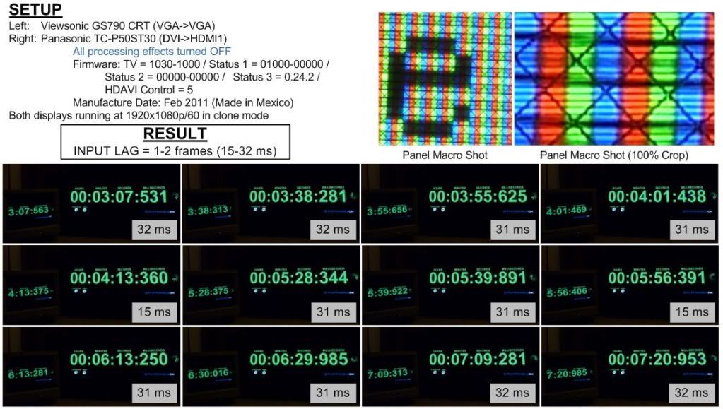

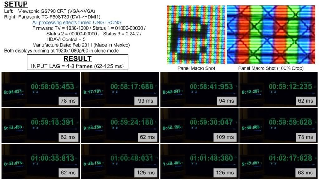

I ran an input lag test on the ST30. For those that don't hang out in the LCD forum, I use the frito method for measuring lag (CRT monitor baseline, verified zero frame buffer lag, verified zero Windows lag (Aero), 1080p/60 cloned video, 1/60th shutter speed, using only pictures that have zero ghosting, etc). The one weakness in my setup is that I use the flatpanelshd exe timer instead of the SMTT timer. But from comparing my flatpanelshd results to SMTT results by others, my results only vary by 0-1 frame of lag. So still pretty solid and accurate. And here are the results...
Panasonic TC-P50ST30 (all processing turned off) = 1-2 frames of lag (15-32 ms)
Panasonic TC-P50ST30 (all processing turned on/strong) = 4-8 frames of lag (62-125 ms)
Note1: in the 'all processing turned off' test, relabeling the HDMI input to 'Game' or 'Monitor' had no effect on lag.
Note2: in the 'all processing turned off' test, these are actually D-Nice settings.
Also, although I don't have any plans on using a plasma as a computer monitor, I ran the 4:4:4 chroma test anyways. And the result... it fails. You can see the result here: link. In case you're wondering what proper 4:4:4 rendering looks like, see this: link.
Note: in the 'all processing turned off' test, relabeling the HDMI input to 'Game' or 'Monitor' had no effect on lag.
Someone posted awhile back that it was 17.5 ms in game mode with all processing off.
Ahh well, 31 ms isn't to bad.
[IMG]http://i807.photobucket.com/albums/yy352/floatpoo/tv_testing/panasonic_TC-P50ST30_p1_lag.jpg[/IMG
[IMG]http://i807.photobucket.com/albums/yy352/floatpoo/tv_testing/panasonic_TC-P50ST30_p2_lag.jpg[/IMG
Thanks for the detailed work and report pooh. Looks like about the same results as the more accurate CRT tests on last year's models, I'll be sure to add it to the lag thread.

Yeah, I didn't know what the other guy was using. He just posted 2 pics in the dark.
But none the less 31 aint bad.
Would be cool if we could get some game shots of this thing in game mode with all processing features off.
