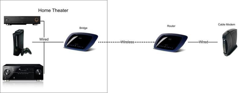

  • Airplay
Probably the big one most people are interested about. Airplay takes a little getting used to, but I'm convinced that's more Apple's doing than it is the receiver's fault. That said I like it quite a bit. Especially due to the 2 Zone limitations (More on that later). A little info on my setup. I have used DD-WRT to convert a router into a wireless bridge for my home theater setup. Basically this means that I have all of my home theater components wired to a network component that connects to a 2nd wireless router that connects to the cable modem.
The end result is that as far as the 1021 is concerned, it has a wired connection to the network.
With that setup, any computer on my network with the latest version of Itunes is capable of setting the 1021 as one of its speakers. The little airplay button appears in the bottom right corner of itunes. This happens as long as the 1021 is on. It does not have to be in HMG mode, however as soon as music starts the 1021 will switch to HMG mode. Where I have had difficulty is I can't seem to get my remote to control the receiver when it is running airplay. Normal play/pause are treated as receiver commands (Play acts as Phase control for example). If I put the remote in HMG mode commands push it OUT of airplay and to the HMG home screen. Music stops until I stop and restart airplay on the computer. There doesn't seem to be a 'Back to Airplay' function on the remote or HMG screen either. Frustrating but works great if you leave it alone.
