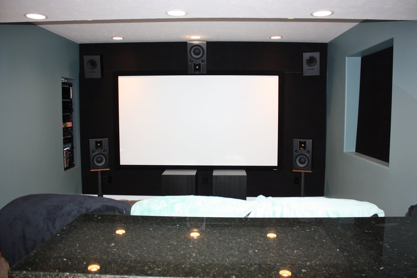

Latest setup pictures: treated screen wall and window inserts...next up ceiling reflection point for center.

You need an AT screen. Ceiling mounted (that's what you have) CC is a really bad idea.
Otherwise, looks like a fun little system ...
RMK-
I know. I didn't plan well enough. I had everything framed and practically drywalled before I realized AT was the way to go.
If I put a ceiling acoustic panel up there for the center do you think that it helps a bit? I was thinking of putting the center below screen, but those are the best locations for my subs, and I want bar seating to still hear the dialogue well.
Problems, problems. What to do, what to do. Move and rebuild, I guess.
Oh, and my bar is secured to the foundation and tiled behind. No AT unless I go smaller screen by 20 inches to 100.

RMK-
Maybe I'm missing something here but you could just hang the screen from a plywood valance that attaches to the ceiling (I used L brackets for a 10' X 24" 3/4" plywood (edge trimmed with 1"X2"). I covered this with black fabric and ... instant (almost) screen wall!
You will need slightly more (6" or so) than your speaker depth off of the wall and I used some closet pole braces for the bottom of the screen.
With this concept you would not be limited by the size except I'd leave 12" to 18" on each side for access to your equipment. It will move your screen closer to the main viewing positions but since when is that a bad thing.
Just a thought ...
This is what I did and it works great!
I agree it looks great but your front three are a large triangle. If center was below screen they would be much more on plane with each other. You could seperate the subs slightly and place cc between pulled away from wall so front slightly in front of subs. You can easily test by taping piece of string or fishing line... just below screen and pulling toward bar seats and see if it would clear front row heads. Worth a try.
I could do this, but since the rack is literally 5" from the screen wall, I'd need to practically cut new holes and just make a standard screen wall. Then I'd either need a smalls screen or move back the bar seating. I may just wait until the next house for AT
Just a thought ...
I might do this before the GTG. All I would need is run longer wire for the center, snake it behind the screen which isn't flush to the wall, and move the subs apart (and find a stand for the center).
My screen wall panels don't totally connect behind the center channel, though, so I'd have to build a tiny insert to put where the wall bracket for the cc was.
I could at least try it...eh?
