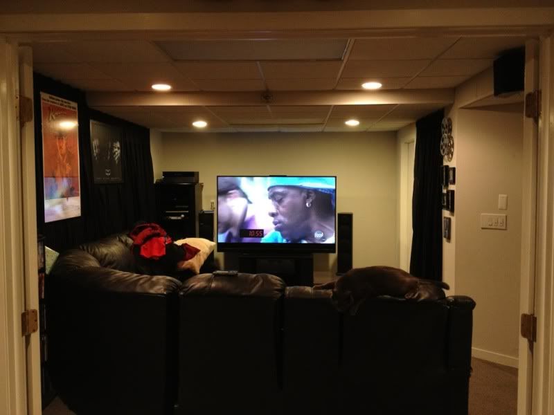

Like I mentioned earlier - I kind of got "pushed" to do the lights in the movie room today... So much for my plan to just relax and watch movies all day! Regardless - my father in-law came by to help, which I'll never turn down! He does heating and cooling for a living and has a lot of electrical experience
We got it done quickly with no issues. I haven't taken out the fluorescent panels yet... Will do that some time this week.
Finishing up the switches...
MUCH better lighting!! It isn't blindingly bright anymore! ... watching Coolio cook on the cooking channel...
Chessie came down to check out the new lights:
The switch panel as it is now... I'm leaning towards just getting another Lutron switch instead of the x10 and calling it a day...
That would save me about $250 over changing over to Insteon... BUT I really want all black switches
Anyway... That's it for today.

Updated shot of the front of the room:
Missing a crossbar for the drop ceiling in the position where the fluorescent panel used to be - but otherwise I think it looks a whole lot better!
Deciding on a color for the front wall still. I was originally thinking dark grey, but my wife - in a strange twist - suggested painting it black. I wanted to do black from the start - but she was always against making the room "too dark".
I'm thinking "mouse ears" in an eggshell finish would probably be the best option.
