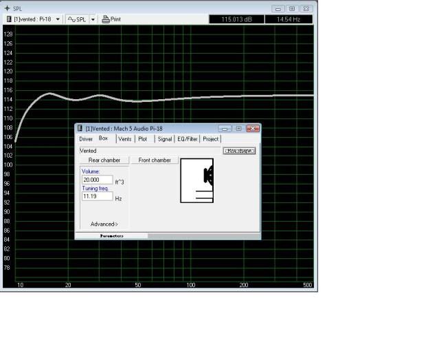

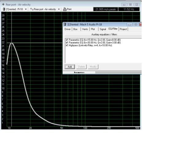

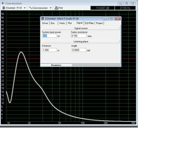

The WinISD default recommended -3db enclosure comes up as a 17hz tune in only 9 cu^3.
I modeled it with a high pass at 17hz.
It starts to exceed x-max at 4500 watts.
I never used to change which alignment it autocalced, sweet! Of course I did the -6dB lol 12 cubes 13Hz
Then I had some fun with a 20cuft enclosure 48" long 8" port 11Hz tune only 400 watts gives 110dB to 11Hz 115dB from 15Hz on up. EQ +8dB @ 15Hz and +3dB @ 30Hz, used 10Hz HP to compensate for electronics rolloff. Xmax is surpassed from 14Hz-18Hz but still under Xmech assuming this is 40mm-44mm... peaks at 38mm at 16Hz... bumping down the EQ at 15Hz a notch or two would fix that if it worries you. Air speed peaks at 22m/s @ 12Hz and would be even less with less EQ.
Sub at the bottom, port going strait down from the top, 6' enclosure standing in a corner with 8' ceiling the port would load into the corner. Otherwise do a slot port.
