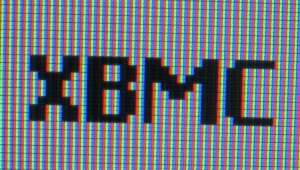

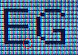

Only for the advanced users. take a look at my post:
[quote] Could we conclude that Samsung D series doesn't have the perfect 1:1 pixel mapping or its just a D5000 series?
Could we conclude that Samsung D series doesn't have perfect 1:1 pixel mapping?
Interesting to see but seems no one reported that 32d5000 doesn't have the perfect 1:1 pixel mapping, I will show on the pictures that horizontal pixel grid is not aligned as on the Samsung LCD devices that were aligned perfectly.
Every setting is made in the PC mode connected to the HDMI/DVI port 1, its tried with the Intel/Nvidia HDMI output on the sandy bridge hd 3000/Nvidia 540m, also it was tried on the pure Nvidia gt7500, also it was tried on the AtiHD4400
And the results were these:
The question would be, were there any service menu option which could shift H-pixel alignment for one or a half of a H-line to align the grid to 1:1 pixelmapping, because the current situation isn't satisfying.
Here is the picture of the aligned 1:1 grid on the other Samsung LCD
Edit:
I'm calling all xxd5000 owners/users which have Digital Camera to set the PC mode(labeling the device input to the PC) on the HDMI port 1, of course for ATI owners take a look at overscan settings its on by the default.
Please disable cleartype fonts and font shadowing
You can use this tool to disable both function on Windows systems:
http://karpolan.com/software/clearty...ype-switch.exe
Place your camera at very close position, set the macro mode, set the ISO settings according the room lighting and value of your contrast from your panel, and take a raw picture.
Lets look at the pictures.
The first red flag for the Samsung changes in the image processing policy were the enabled sharpness settings in the PC mode.
On all previous series including A, B and C versions the sharpness were disabled in PC mode and the pixel grid were aligned to 1:1 in PC mode.
What happen, why Samsung decided to change the things, virtually they made the D series unusable!
I would like to see the other pictures from the users who owns Samsung D series that we could see were the all models in D series doomed or maybe just the D5000.
I'm calling all XXD7000 users to make digital camera photoshots of pixels in PC mode that we check D7000 series is there perfect 1:1 pixel mapping or the pixel grid isn't aligned like on D5000 series.
Set the PC mode(labeling the device input to the PC) on the HDMI port 1, of course for ATI owners take a look at overscan settings its on by the default.
