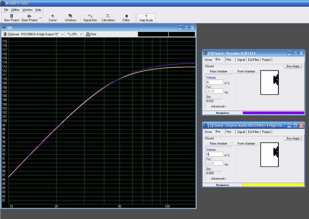

Subupgrade: 2X12" Bazooka subs in 2 ft^3 boxes. I rebuilt the cabinet doors to have a grill cloth insert so I can hide the admittedly ugly boxes. I'm driving them with a large vintage amp at about 150 watts each.
