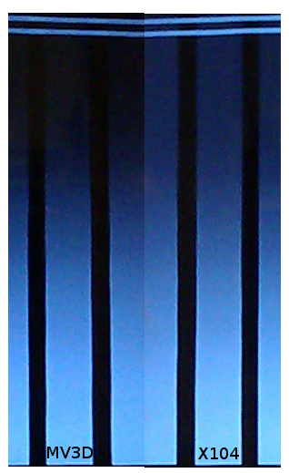

These images I took when trying to figure out WTF is up with the anti-ghosting filter and its bizarre tuning settings might help, though of course, my efforts to prevent the cell phone camera from doing its own jiggering may not have been as thorough as possible.
Note the spectral shift on the center set of vertical bars on the results images is set-induced, and the last column of the MV3D test image was suffering from back reflections.
([del]See the embedded image comments.[/del] Photobucket apparently now munges your image files, so I'll paste the embedded comments in the comments section there shortly)

post #133 of 186
Originally Posted by zkidz View Post
This is true. However, a lot of displays considered to be bad ghosters could be at least watchable with the current tunable glasses options. In many cases even the vendor supplied glasses kit is inferior. In my case, if I could just get the stupid anti-ghosting filter turned off, ghosting would be at pretty tolerable levels.
Yes that is what exactly what I was getting at. Main main point though was as you agree, the display tech itself is most to blame. It wasn't until the current era tuneable glasses, since the bit cauldron/MV3D/Optomas and now the X104s finally, that much could be done to try to compensate for what the display inherently was doing wrong. For me had I still been using the quite ghosting prone VW90 proj, I may, but will never know or really care(due to its impossibly dim first gen 3D tech), tune for better performance. I do own 2 HX series Sony panels as well. However, given the sheer lack any compelling reason to watch 3D away from my current proj, I haven't even tried using the X104s with my flat panels to examine and compare the diff between say them and the current gen Sony glasses with ghosting issues.
