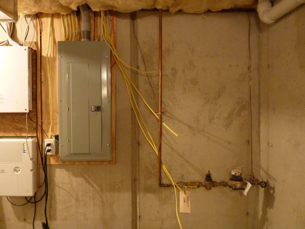

One word of advice, LABEL THE WIRING AS YOU RUN EACH OF THEM!!! I forgot to do so and only have one labeled. I am going to short the ends of each cable and use my Fluke to find which them so I can label them now. Would have been simpler had I done it beforehand.

Heh - always a good idea and it was something that I did for my electrical wiring but completely forgot to do for my Ethernet wiring

Just a thought from my basement build-out experience. Take a look at installing a whole house surge suppressor on your electrical box. Surprisingly inexpensive and will protect all of the new electronics (plus everything else plugged into a wall!).
post #73 of 213
I honestly am thinking about it...maybe this one, from Lowes:

I will be buying the T2 instead of the T1. Only about $10 more.
