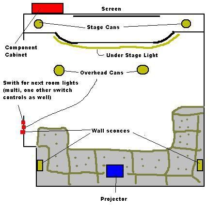

Here's a basic diagram of my set up, since I've read some of the Lutron systems require a very direct line of sight to work correctly.
The 5 sets I'd like to be able to control and set independently are:
- Overhead Cans
- Wall Sconces
- Stage Cans
- Understage Light
- Cans in adjoining room
All are incandescent, and the understage light is a rope light. I have not wired up the Stage Cans or understage light yet. The other 3 zones are wired into a gang box to the left rear of my room. I'm planning on wiring the new 2 zones into or near the existing box of 3 to keep all my lighting controls in the same spot.

- My component cabinet is going to be housed behind a piece of tinted glass, but should I look into installing an all-in-one IR module to combine all the signals to one distinct point I could hide below the screen? Could I also do this for the switches, assuming that I have to use IR? Do they make something that could detect an RF from the remote, convert it into IR where appropriate, and then send it to everything? The one thing I want to avoid with my switches on the left rear wall is having to point the remote at the cabinet for one button press, and then at the gang box of switches for another. (however, I would like to keep the gang box where it is for manual operation when needed).

I agree that once you start wanting to control lighting in conjunction with your AV equipment, start looking into URC or something similar. I have zero programming experience but wanted a similar setup to what you're looking for. I'm working with a home automation guy and the URC MX-980 was my top URC choice to control the AV equipment and lighting scenes from one stick. I will be using Lutron's Ra2 system for my lighting, which is friendly for retrofits as long as your lighting was wired with a neutral.

X10 lighting control is an inexpensive option. While you can't do scenes, you can control the modules ( switches and plug-in lamp modules ) via IR using an IR-543 controller. Most universal remotes have X10 codes in their databases, including the Harmony remotes. If used for a single room setup, and if all loads are on the same phase, it can be quite reliable.
As others have suggested, URC has a special Lutron line of compatible dimmers. The least expensive remote that supports URC/Lutron lighting is the MX-450. It's a RF remote similar in features to the Harmony 900. While the remote is available on Amazon, the lighting modules are not. You have to source them from a URC dealer or custom installer.
The next step up is mesh networked modules. Z-Wave is dominant right now for home applications, although Zigbee is gaining ground. Neither of these solutions have a direct IR interface. You need a PC to act as a controller and equip it with an IR interface. The IR interface to the PC sends triggers that the Home Automation software reacts to and controls scenes via Z-Wave or Zigbee. This is now getting into Home Automation territory. www.coocoontech.com is a good resource site to learn about these technologies. The older Harmony 890 and 1000 can control Z-Wave directly, but they are discontinued models and Z-Wave support is limited. Newer Harmony remotes don't have Z-Wave support.
After this come the Radio-Ra's, Control 4's, and then AMX and Crestron offerings. All are dealer/installer only products.
For the setup you propose, you could probably get away with just using X10. Then you have a broad choice of universal remotes. I have both Harmony and URC's. Harmony's are simpler to setup, URC's offer more flexibility. It comes down to preference. Your total cost for the light switch dimmers and lamp modules, plus an IR-543 would probably be under $100 if you shop the eBay vendors.
