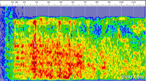

After watching the movie several more times and more closely analyzing the 3-120 Hz content (LFE+RB through the SW output), my personal opinion is that the soundtrack as a whole is not filtered.
It appears by the evidence that the individual effects were filtered. Most of them are filtered, but a few of them are not because some spots show content to 5 Hz.
The <20 Hz content is much more sparse and attenuated than in X-Formers. In fact, in scrutinizing all 3 movies, there is a trend of filtering <20 Hz in the effects. The best example is the footsteps of the bots. As I posted 2 captures earlier, the bots' footsteps were very prominently ULF in the 1st movie, less so in the 2nd and non-existent in the 3rd, which typifies the trend.
This is really a shame, IMO. In the 1st movie, the footsteps, staying with that example, typically do not coincide with a headroom problem and very effectively convey the weight/size of the bots. In my case, situated on a large wood frame floor system, the ULF pressure waves cause the room to react as though the bots were right in front of you. This sort of ULF-reproduction-in-the-home experience is relatively a very recent one for humans, and, therefore, a very impressive experience for everyone, either way one may view them.
IMO, these sort of effects are a huge plus to the experience if your system has the capability to reproduce them, but have no effect, ill or otherwise, on a system that isn't capable of reproducing them. So, why filter them?
I recently played the opening scene in Star Trek, where the Romulun mining ship emerges from the black hole, for guests, with full bandwidth playback and with a 20 Hz HPF in line, and asked them if they perceived any difference and if so, could they describe the difference.
One person said something like; "Waaay different. the whole seat moves. It feels like the walls are moving... the whole room moves!".
Here's a visual:
Anyway, I retract my first declaration that TF III; DSOTM is filtered. I now believe that individual effects have been either designed with no ULF or filtered as part of their creation, but some are not, based on the SpecLab graphs. I also believe that the 3 movies in the series trend toward less and less ULF content, thus my 3.5 star rating, bumped to 4 stars by sheer amount of bass content.
