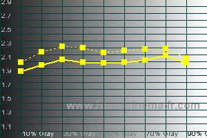

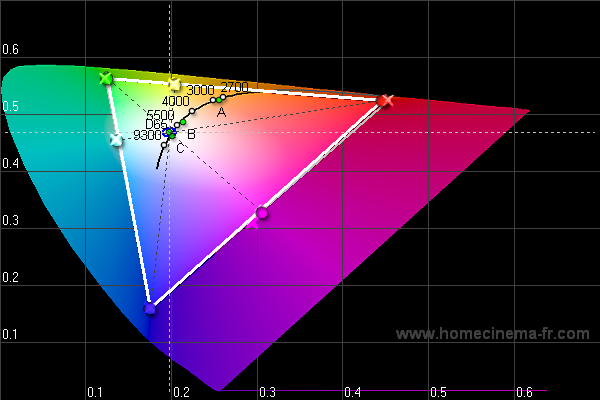

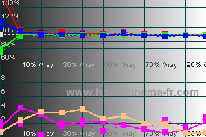

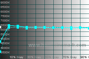

I've done a quick cal of Cal-Day mode on my display, copied the settings over to Movie mode and compared the results. I was interested in the custom color setting since it is common to both. All other controls 2-pt WB, 10-pt WB, etc. can be set individually.
I didn't try flattening out the gamma curves just yet, but gamma in Cal-Day mode is lower than movie mode. Average gamma = 2.24 (top, movie) and 2.09 (bottom, Cal-Day) This is with gamma=-1 (movie) and -2 (Cal-Day) and remember that lower settings of gamma on this display increases gamma.
WB and color temperature were very close between the two modes but this can be adjusted separately for the two modes anyway.
Color space matchup was pretty good except for red (and therefore magenta as well). Filled circles are Cal-day and X's are movie. dE(uv) between movie and Cal-Day were: 12.4 (red), 2.1 (green), 1.0 (blue), 2.1 (yellow), 2.7 (cyan), 16.0 (magenta)
post #224 of 3248

The settings posted so far in this thread apply to movie mode only. There are a couple of differences between movie and the CAL-D/N modes. One is in the way gamma behaves, gamma is lower in the CAL modes. Also, there is a difference in color (mainly red) and since they share the custom color space if you calibrate for one mode there will be errors in the other. This all applies the D8000, D7000 is not confirmed to do this yet. I am working on settings for D/N mode but it is proving hard to get a decent gamma.
EDIT: Here are the Day/Night settings I am currently using, posted on 1st page as well.
Mode CAL-DAY CAL-NIGHT
Average gamma (fixed APL) 2.1 2.28
Peak White 35 ftL 28 ftL
Cell light 17 15
contrast 82 78
brightness 49 50
sharpness 8 8
color 46 46
tint 50 50
black tone off off
dynamic off off
gamma -1 -2
flesh tone off off
edge enhance off off
motion lighting off off
xvYcc off off
color tone warm2 warm2
digital noise off off
mpeg noise off off
color space
Red_r 26 26
Red_g 3 3
Red_b 4 4
Green_r 18 18
Green_g 48 48
Green_b 0 0
Blue_r 0 0
Blue_g 0 0
Blue_b 49 49
Yellow_r 48 48
Yellow_g 48 48
