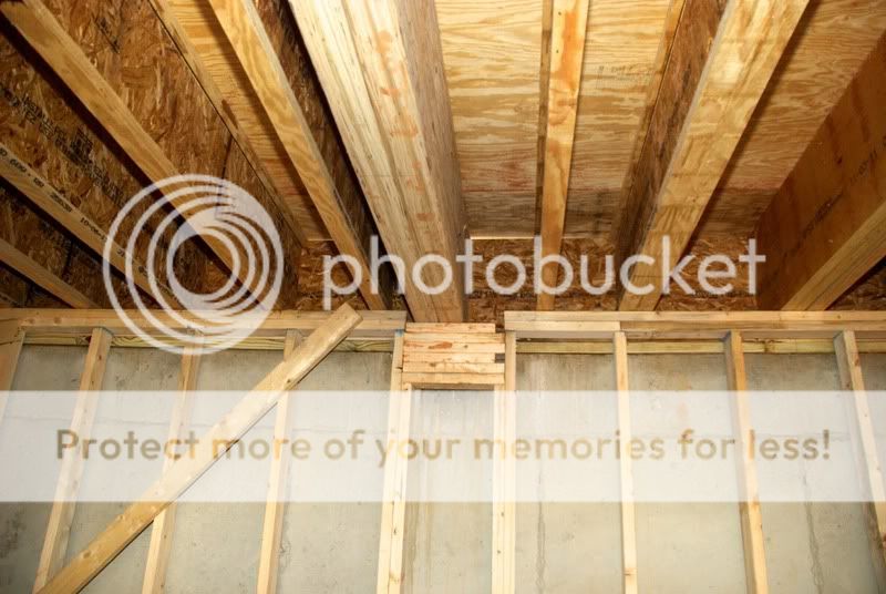

Here's a picture of the replacement beam being set. My dad was there for this part, and he said it gave them fits trying to wrestle the thing into place.
Here's another picture after the decking was installed from in the theater. Notice how thick that beam is Both the framer and our contractor said they don't remember seeing a house with as many laminated and doubled beams as this one. I don't know if that's a good thing or not You can see in that picture alone there is another doubled up I-joist as well as another laminated beam to the right.
And here's a (bad) picture of the doorway into the theater after they reworked the wall to open the area back up. I think we made the right decision here, it feels much less cramped now. Even our contractor didn't care for the way they had it, and I think he would have made them change it even if I hadn't noticed it.

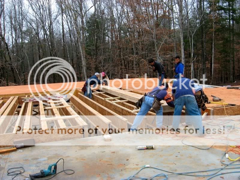

Framing is moving along nicely! They're getting close to being finished with the first floor today, and have the floor joists for a good portion of the second floor done as well.
It was actually a pretty eventful afternoon. They brought in a large laminated beam for the garage late in the day, and the truck it was on got stuck in the yard. So they brought in another truck with a fork lift to set the beam on top of the garage (see the picture below). I'm sure you can see where this is going, but after they unloaded the beam, we decided we could try to use the forklift to push the truck out, and yep, you guessed it, the forklift got stuck too! When I left they were waiting on yet another truck to come pull them both out. I half expect to stop by there tomorrow and see a line of stuck trucks out to the road
