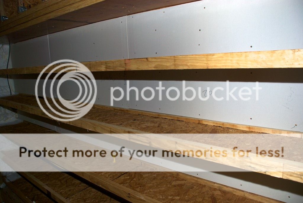

Another minor update. I've started cutting my drywall to go between the floor joists in my ceiling. I wasn't planning to do this originally, but decided to after hearing my dogs walking on the floor above. Ted recommends 2 layers, but I don't think I'm going to add the second. I'm sure I'll regret it later, but my concern is really eliminating noise getting out. So, I'll try to get some really boring pictures of drywall up later to keep you photo hounds happy smile.gif
I've also been working on my overall layout a bit, and I think I'm settling in on a final design. I've scrapped the coffered ceiling idea, I'm sad to say. There's just not enough head room on the riser. I've attached my current plan, and I'm sure it will look familiar to some of you. It's a pretty blatant copy of Mario's theater biggrin.gif The model is not exactly right, and getting the colors correct is tough in Sketchup. My screen wall will be different a little different from Mario's, as I'm planning for AT fabric so I apply some acoustic treatments up there. I'm still thinking about a color scheme, though. I really like black and red, but I wouldn't mind doing something a little different if I can find something. That said, I don't want to pick something I like less just to be different. I'll put more thought into it as I get closer to choosing colors.
Black's don't show up well in the model, but this gives you the idea I think.

Here's proof that I've been doing something. Not much, mind you, but when I get a free minute here and there, I try to make good use of it.
Here's my DW cut to fit between my floor joists. Since this is supposed to treat footfall noise, I decided not to do the area below my son's room since his room is carpet. My primary reason is just worrying over the stray screw head poking up into the carpet above.

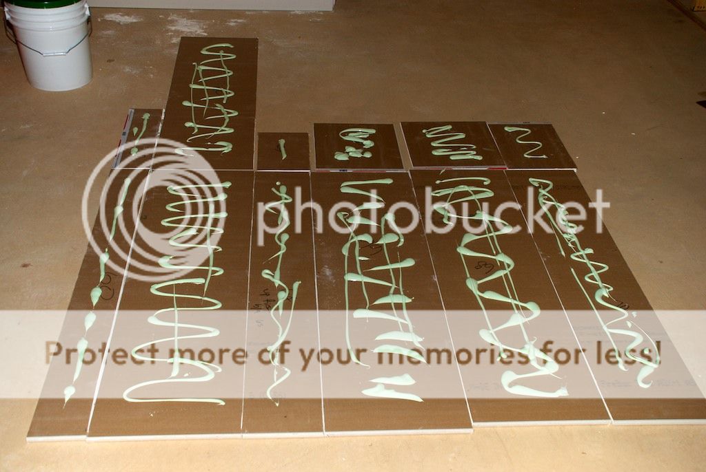

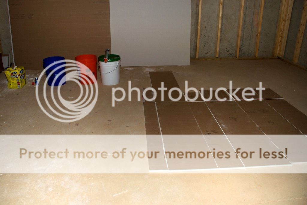

Time for the initial GG update. I've got all the pieces on the subfloor up, and I have to admit that working with GG is not as bad as I had expected. I thought I would post my process as well as my photo proof of progress in case it will help someone else along the way.
Things you need before you start that you might not think of before you do this the first time:
2 - 5 gal buckets. One filled 3/4 of the way full of water. You can use the empty bucket as temporary storage for your speedloader, and you can use the bucket of water to cycle water in and out of the loader and leave filled if you are going to be away for more than 20 minutes. Even if you don't think you'll need to stop, I'd recommend that bucket of water. You'll need to take a break at some point, and it's easy to have it there so you can store the speed loader easily.
1 - Can of WD40. This stuff works wonders for cleaning GG of you! You also use it to lubricate the speedloader, but that's a much less impressive use of the stuff rolleyes.gif
1 - Box of shop towels. Paper towels will also work, or anything you can use to wipe up spills. I would recommend something disposable, though. You don't want to end up just smearing around GG already on your rag.
1- Trash can or box to throw your dirty towels to keep them out of the way and off the floor. You don't want to step on a rag with GG on it and then spend the rest of the day tracking it around.
Here's my process (Some of these come directly from the SIM, others are what I learned along the way):

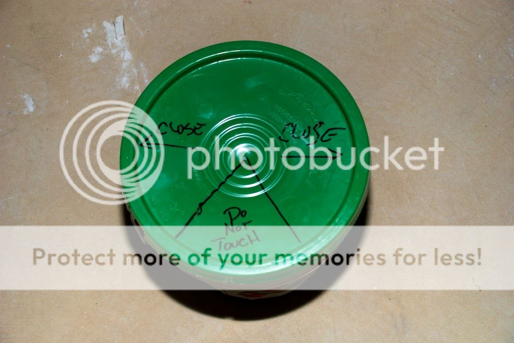

1) First I arranged all of my stuff. A work area for applying the GG. My GG immediately next to that to limit drips on the floor. My two buckets, WD40, and shop towels next to that.
2) Label the top of your GG bucket with 3 regions (you don't actually have to label it, just remember where not to touch; but it serves for this example). The first is an area you don't want to touch. This gives you a place to wipe the loader nozzle on the bucket lip. The GG will get on the lid's seal the next time you close the bucket, and if you grab that area when you open the top.... well, refer to the WD40 note above. The other two areas are where you can seal the bucket temporarily between uses. This keeps it from drying out, but still easy to open the next time.
3) Since I was doing my subfloor, I laid out 32 - 48 s.f. of drywall. That's 2-3 loads of GG, and that's about what I could hang in 20 minutes. I laid them out and pressed them tight against each other to limit drips on the floor. Below you can see my layout. Note that every piece is numbered and has notes about orientation on it.
4) Load the gun, and apply to your DW being careful to leave a 3" border around the edge to give you something to hold onto. Here you can how I applied the GG, and notice that I left a border along the edge of EACH piece to go up.
5) After you've applied your GG to your drywall, wipe the excess GG off the loader tip on your predefined region of the bucket lip. Next you can do one of two things.
5.a) If you're moving quickly, just drop the loader in the empty bucket (tip down of course). This bucket gives you somewhere to drop the loader that keeps the GG from getting everywhere
5.b) If you're moving slowly, or if you need to take an extended break, cycle water in and out of the loader five or six times in your water bucket, then fill the loader with water one last time and leave it in the water. This was handy for me since I was moving rather slowly putting up all the individual pieces, but it's probably not necessary when putting up full sheets.
6) Rinse, and repeat as necessary.
These are my observations as a first time GG user:
1) I'll say it again, WD40 is amazing for getting GG of of you. Yep, that's right, WD40 is known to dissolve most substances you are likely to encounter on the planet Earth, and GG is no exception. I don't remember having ever read this anywhere else, but the speedloader came with a can, and as soon as I got some GG on me, I immediately reached for the WD40. I sprayed the GG liberally with WD40, and it wiped right off. However you decide to clean off GG, do it immediately. The stuff is sticky, and whatever you touch will get it on it. If you get it on your drill or ladder, every time you touch those you've got it on you again. I'm fairly certain the stuff violates conservation of mass.
2) I expected it to be a different color green. It's sort of a pastel green, and I was expecting the green on the bucket.
3) It has a pretty strong smell. It reminded me of concentrated latex paint.
4) It's a lot thinner than I expected. I was expecting it to be the consistency of caulk, but it's really more like runny pudding. It will hold it's shape, but it's really easy to squeeze it out of the speedloader.
This is the progress I made.

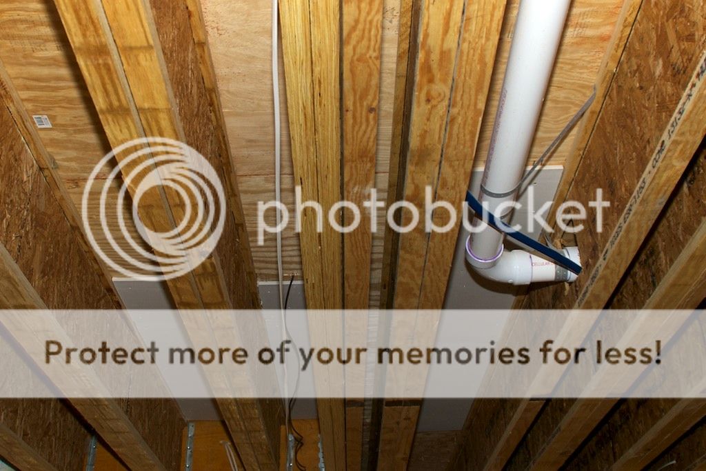

Another minor update. I've started on the my joist muffler for the HVAC supply. This should be the most time consuming of the three that I need to build as it crosses the room. Photo proof as always.
Since I have I-beams rather than dimensional lumber joists, I decided to fill the recessed area with two layers of 1/2" drywall (no GG here). This is just to take up space. When I asked Ted about it way back when, he didn't feel the open space would be a problem, but I had a little extra 1/2" laying around, so why not. Here's a pick of the second layer of 1/2" being started.
Once both layers of 1/2" were up, I started adding the first layer of 5/8" to the sides. Here's the first piece up.
I finished with the sides, and next I'll have to precut all the pieces for the second layer for the top and sides. These will get GG. I'll probably do the first layer for the other two joist mufflers and my one dead vent to try to get as much done with the GG as I can at once.
Also, notice the wire in the photo above. I'm planning to run that inside my joist muffler. It's not ideal, but I don't really have a convenient choice.
And lastly, it looks like my duct is going to take up most of the space in my joist muffler. There will be very little, if any, space left over for insulation. I hope this isn't going to be a problem. I'll probably touch base with Ted before I seal it up, but again, not much choice here either.
post #535 of 959
Insulation is what is bringing the magic. No insulation = no absorption (other than from air resistance). Is the flex insulated at least?
post #536 of 959
Hmmmm.... The flex is insulated. That's it shown in the picture above. It's an 8" line that is wrapped in R-8. So it takes up nearly 12". After DD+GG, I think the muffler will have an 11"x13" opening. I may be able to compress the duct a bit, and fill some insulation in the corners and a little along the bottom.
Should I be looking for a different approach?
post #537 of 959
Ca you accomodate 6" flex? That would give you the room for some loose R13
post #538 of 959
Not according to the heat load calc. The 8" will keep the room cool with people in the chairs, but not if there are additional people at the rear bar. Obviously there won't be that many people in there all the time, but I can easily see us with 6 to 8 regularly (which is what the HVAC was sized for).
Is the concern sound traveling down the ductwork into adjacent rooms, or sound traveling through the joist bay and through the floor above? The former would not be a big deal as the line connects to the trunk line in a mechanical closet and makes some 90 degree bends before entering the next room (all flex). If it's the latter........ that would be a problem smile.gif
post #539 of 959
The problem is the only reason the mufflers, Dead Vents, etc work is because the sound wave meets with constant resistance from the fibrous insulation. The sound wave will not be met with such resistance simply travelling through open air.
The R8 insuloation is minimal for what we want.
post #540 of 959
I may be able to compress the duct into an oval and squeeze in 3-1/2" for R13.
I wish I had stopped to calculate the opening sooner. I could have let the muffler drop below the joists and picked up another 1" or so. Of course, that would introduce its own set of problems.
